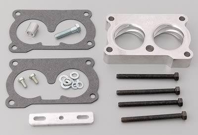

Yes I did consider this, just didn't get around to it, this winter I might machine the ends of the fuel rails on the mill to shorten them, I also considered welding an end cap at a 45 dgree angle onto the inlet side so I could gain more clearance.
But with that said, I ws looking at the clearacne this weekend and I believe that a Throttle Body spacer of 1/2" to 3/4" might eliminate the throttle cable issue on my plenum, I will measure some more and see, I can make an aluminum spacer in 15 minutes on the mill
This weekend I will do some data logs and see if the Fuel pressure return line is an issue, my FP is at 48 PSI no vacuum,, I have the -6AN larger lines that I took off so reversing it is not a big deal.

But with that said, I was looking at the clearance this weekend and I
can make an aluminum spacer in 15 minutes on the mill.
