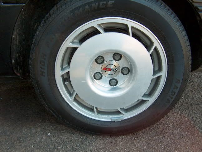

I used precision wheel just had to ship to them. Here are the results:
Before:
After:
Old Jul 2, 2007 | 09:36 PM

Is that Precision Wheel out of Branford,Ct if so excellent choice also notice the wheel weights are not on the outside of rim anymore. Mine are on the outside it looks terrible.

They were extremely great to deal with, I think they had them in transit back to me in a two days. They painted the slots as they came from the factory and then applied the clear powder coat. All four were done.
http://www.precisionwheels.com/
