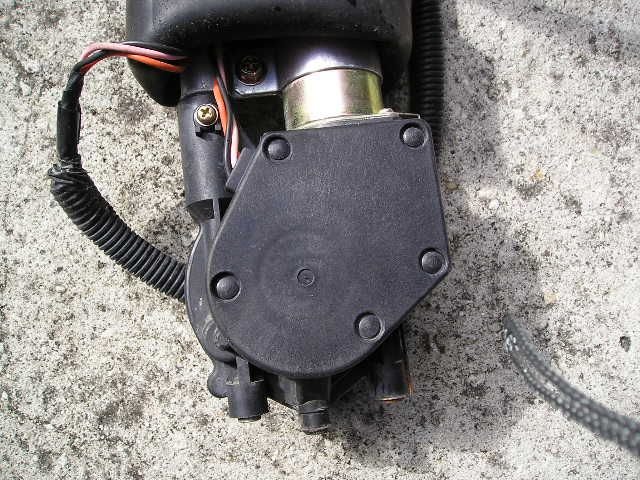

I have now removed the antenna from the car. Pealed back the rubber boot and found all the covers are riveted on. Has anyone else had the rivets or is screws the norm. Looks like drilling the round face rivets out will probably make a mess of things and then how do I reassemble.

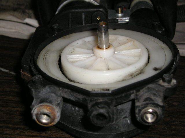

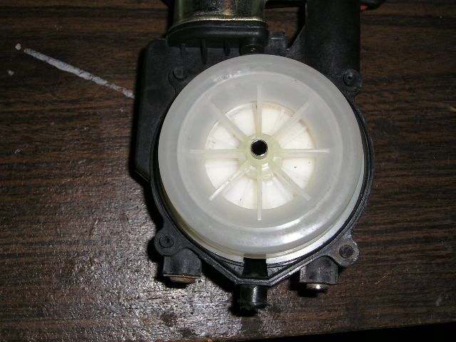

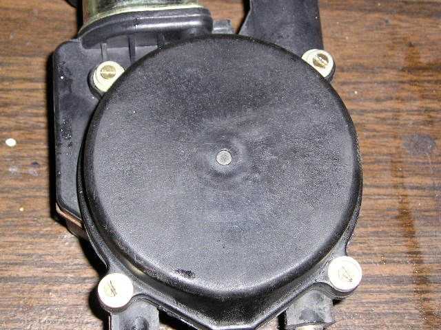

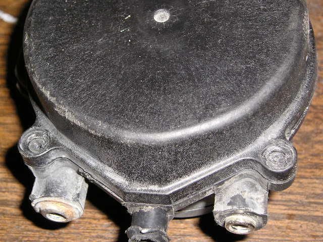

Good success into new territory. Everything worked out really well. I opened the antenna, found a piece of ribbon inside, cleaned it, lubed it, and reassembled. Installed the new antenna, it went down properly and all works normal. This all really worked out well.
Giving the unit a good visual I realized the rivets were plastic. So I drilled the heads off slightly and finished it with a dremel tool. Then I drilled a 1/16” hole in each of the plastic studs. Then got the smallest self tapping screw I had and added a couple of washers. I then had to go up to the next size 3/32 for the screws to prevent breaking the plastic as I screwed it in.
I cant be the only one who had had this situation. Perhaps this may help some others. Took many hours to do all this but saved several hundred dollars. Here are some pix of my progress. Also, installing the rubber grummet back with the wires back into the hole was no big deal.
