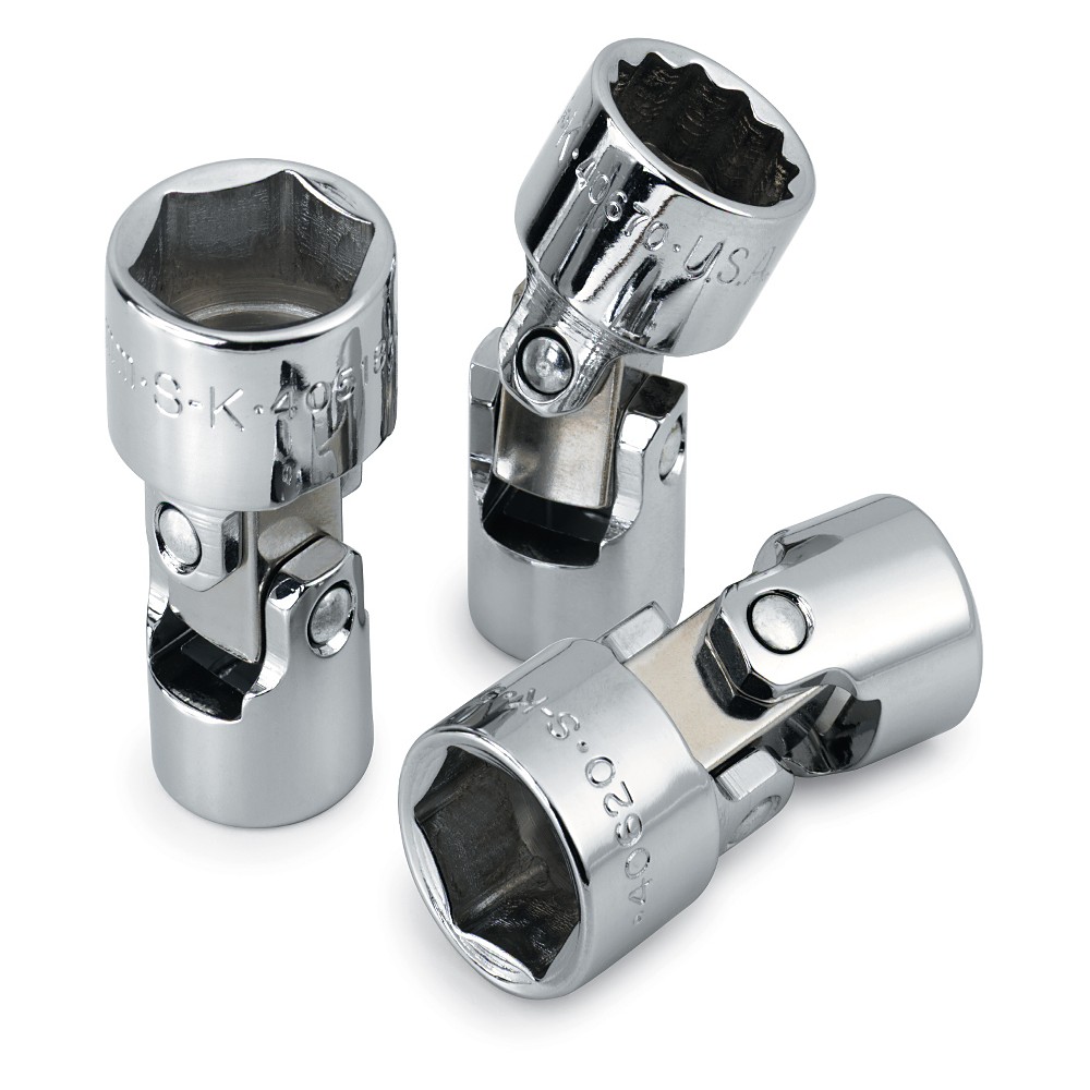

My pump is out right now. A long 9/16 and for that one that hides behind the PS pulley use a swivel 9/16 with a wooble extension and a rachet. The bolt will come out.
It is easier to work down there if you remove the PS tank and coil bracket. I've done this few times and it is very easy for me to do and.. I have a camber brace
9/16 socket
