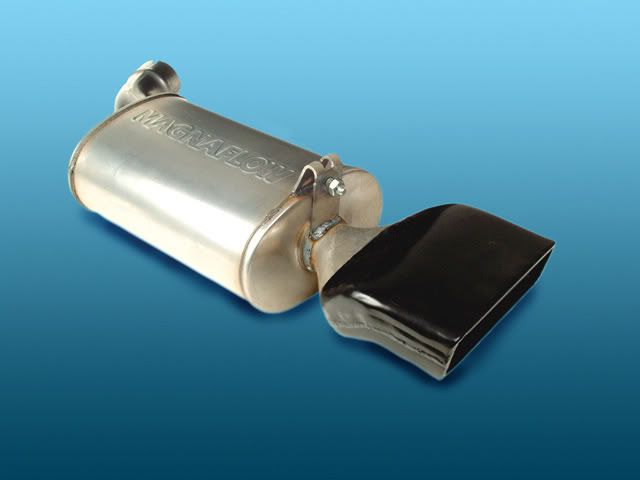

Magnaflow makes a muffler with LT1 tips that may be what you are looking for. I saw them listed in Corvette Central. Not to bad a price either. I think that I'm going to go with these.

A lot of the retailers sell muffler elim's with LT1 tips on them.
