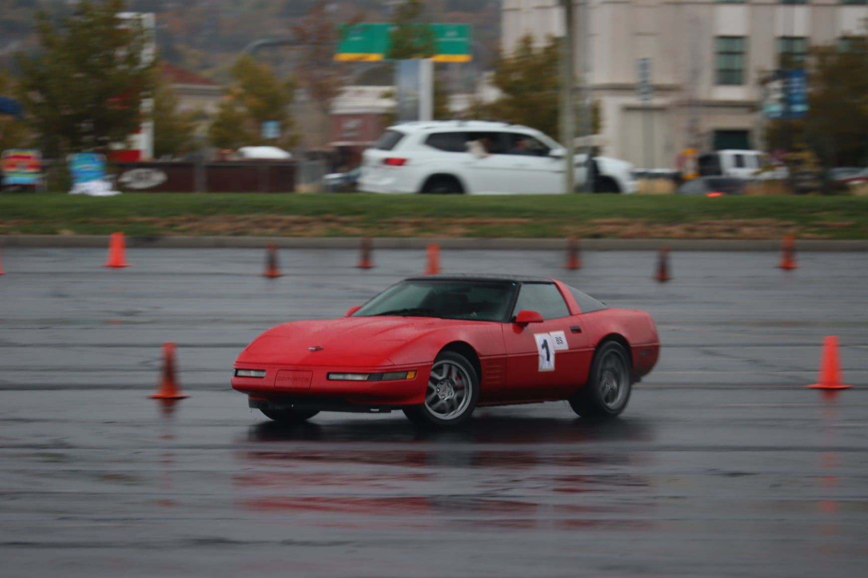

I know it's been answered but here's mine before I put GS knock off on it. 1st day I owned it. Hadn't been home yet.
Thanks for looking,
Joe K

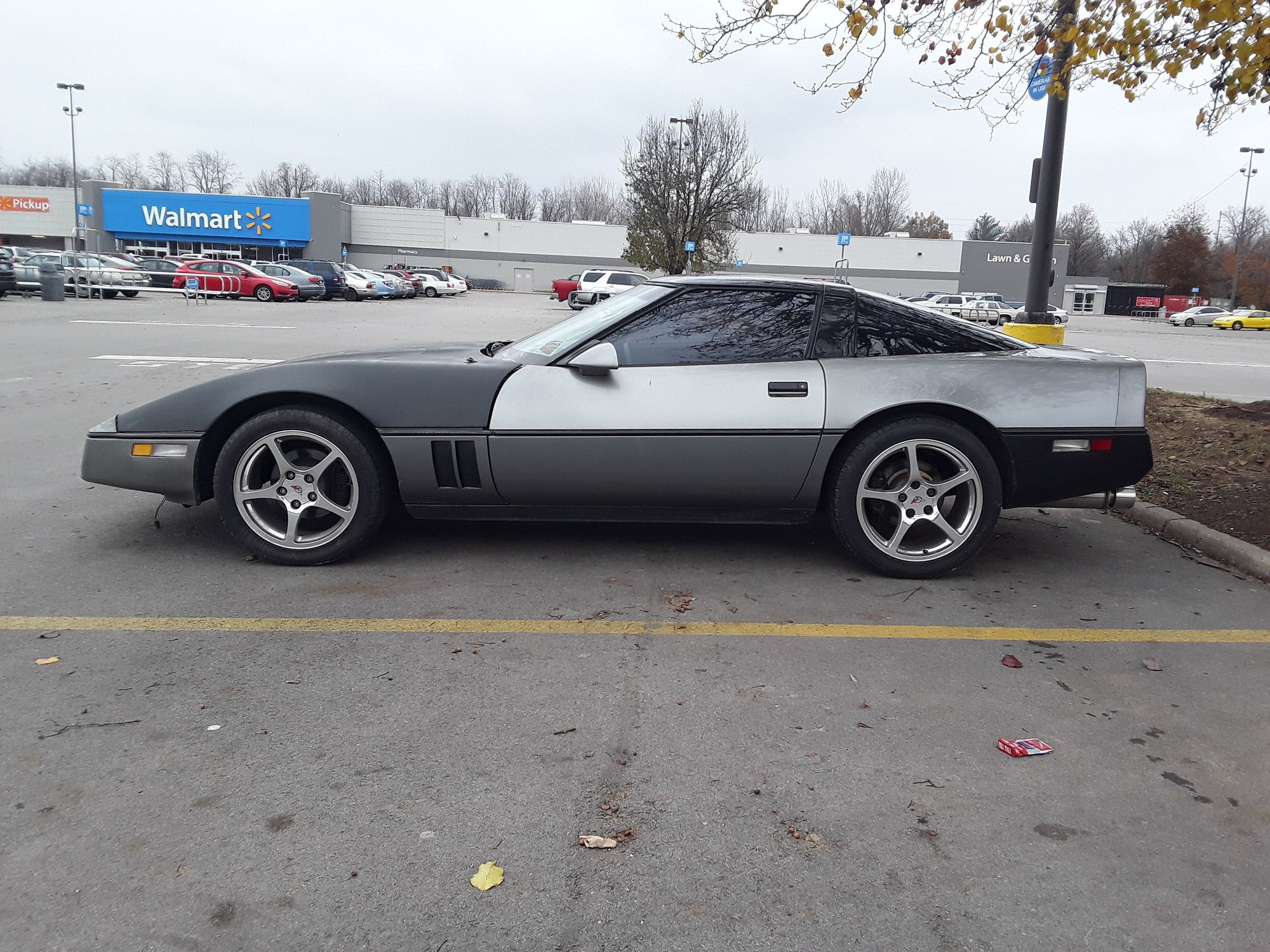

hello which C5 rims are those on your Frankenstein car? thanks, Cheers...

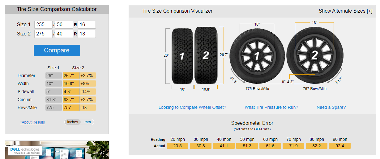

Originally Posted by Fasttimes1971
I know that C5 wheels will fit my 87 c4 with the use of 1” spacers ….. my question is will the stock size rear tire for the c5 (275/40/18) clear the rear wheel opening with no issues? Any help here will be appreciated as I’m getting ready to buy tires
The radius will increase by 0.35 inch compared to stock wheels.
https://tiresize.com/comparison/
285/35-18 will be almost identical diameter as stock.
Lol, Frankenstein, I like that. It's certainly is.
Sorry not sure the exact name. Think maybe wagon wheels. Someone else please enlighten us.
Joe K
Those are just stock 5 spoke wheels for a 2000-2004 coupe (also 2000 FRC). I've heard them called millennium wheels, because they came out in 2000.
