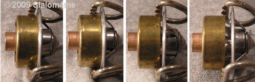

I believe the claim that the RS design is less prone to being closed
by pressure is based on the "measuring cup"-shaped valve - coolant
flows out past the base, around the sides and then inward over the
top of the "cup". The arguement may be that the flat disk-shaped
valve of the Stant-style conventional t-stat does not encourage
flow around the valve in the same manner.

A sequence displaying a Robertshaw t-stat in four states:
