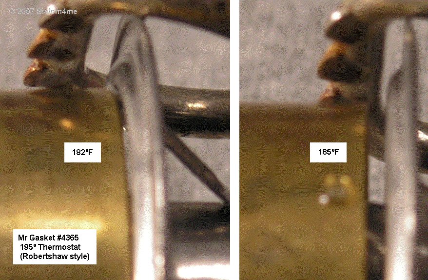

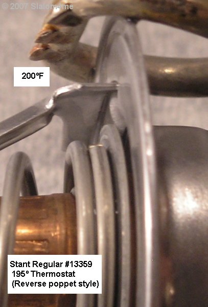

The real actuation points of some thermostats are at variance
with their advertised actuation points. Both the RS and the Stant
below are rated for 195º. Guess which one might seem more
effective ...

So your saying with the pictures the RS thermostat that is 180 degrees from ecklers is the best way to go for me then?

Look again at the captions for the pictures in post #5, as well
as the position of the valve.
By testing your t-stat you will know with certainty when it begins
to move and when it is fully open. If it is marked 180ºF but begins
to move at 155º and is fully open by 165º, then it may contribute
to engine behavior that is unsatisfactory.
