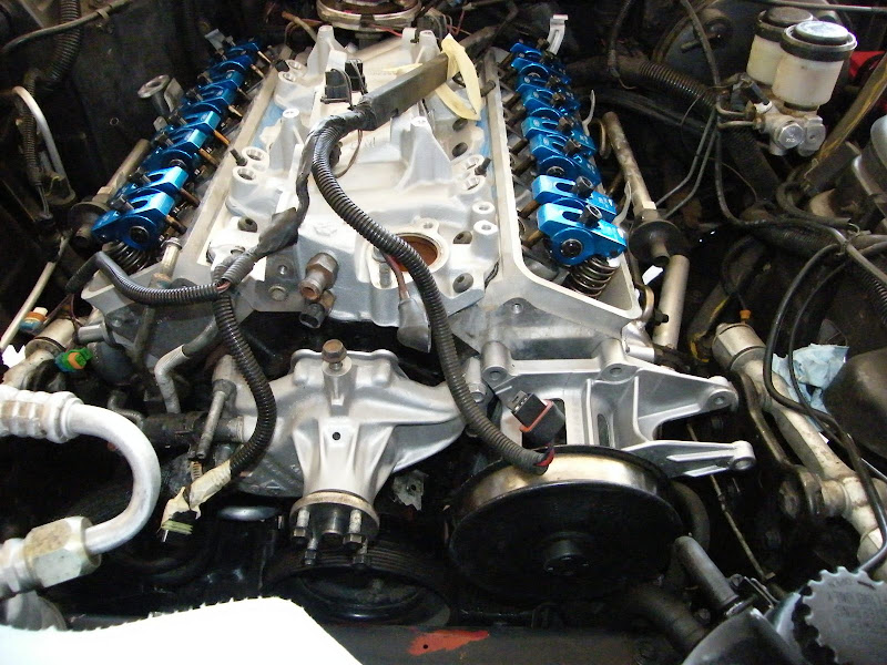

OK, enough whining!!!! RTV ............. Right Stuff ......... Chewing Gum!
It went better than I thought I used the Right Stuff, not crazy about the cheese wiz type can but I've got a nice even squeze around all side that I can see, l'et;s hope for the best.

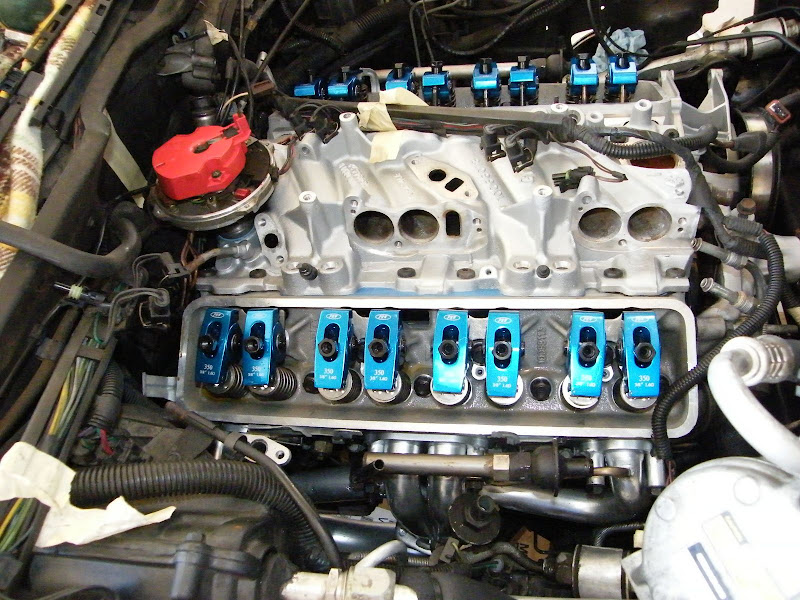

Is that where your distibutor Sits with the wires from the mod coming out to the front, when I put mine in the wires exit in the back.... Close to the firewall, I wonder if mine is in wrong.....

Originally Posted by rte203
Is that where your distributor Sits with the wires from the mod coming out to the front, when I put mine in the wires exit in the back.... Close to the firewall, I wonder if mine is in wrong.....
I can't remember what time I took this shot. I did review the distributor late today and ended up moving it a bit, but I think it was only of by 1 tooth. I'll have to check if this is the final position.
Also there are tow set of wire out of the distributor, the one in from here has only two wires I think, there is one in bank with a much large plug and more wires.
