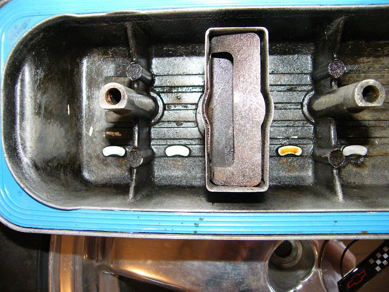

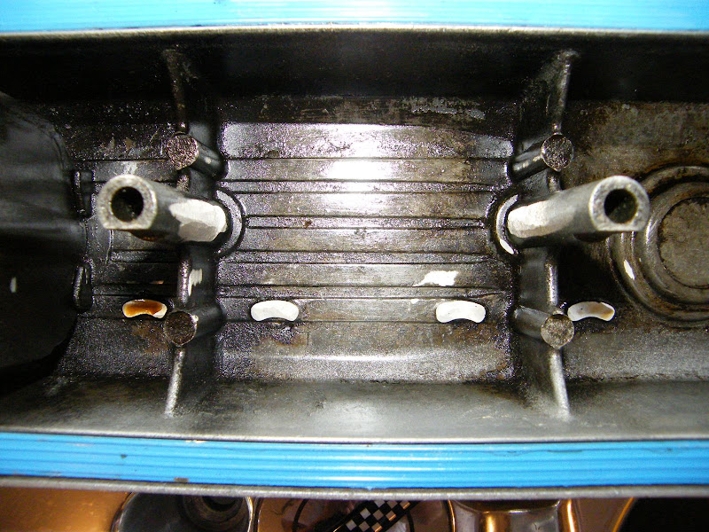

OK, got the valve cover off and found my thought was right #3 intake was very loose, the nut had backed off from the trunnion. Push rod checked out OK, rocker looked fine.
It looks like potentially what is a problem help, I think the vavle covers with these rockers is very close on clearance and potentially maybe even hitting just a bit. I've included a couple pics for you review.
Now I did some grinding before install to remove drip tabs and even ground a bit of material from the center posts you'll see. but there are a couple marks above where the drip tabs were that I can't remeber if I did during the grinding or not.
In the photo above I think you can see where the nut backed off of #3 intake and left a slight mark just above the drip tab.
So I've installed the rocker and readjusted, then went and snugged a bit more on all the others on that back for safe keeping.
But I don't think I'm going to install these covers, I think I'm going to pick up some aftermarket covers that maybe are 1/8 taller or so just for insurance. If I throw these back on and I've got issue with them just rubbing I'm asking for trouble, and that will **** me off.
Not to mention but with one on and off the paint job that I worked too hard on looks like crap already!
Anyone that can offer a recommendation on a cover that is very close in size, chrome or polished preferred that doesn't break the bank?
More to come!
UPDATE
I had a chance to measure the covers and the center post are 3" to the inside top of the cover, then I put the tape measure between the rockers on the seat for the post and the highest point is the poly nut at about 2 5/8" so I think there is enough room after all, I guess I was just frustrated! I think I'll put loctite on these and then button up this side for now and see how things are.
