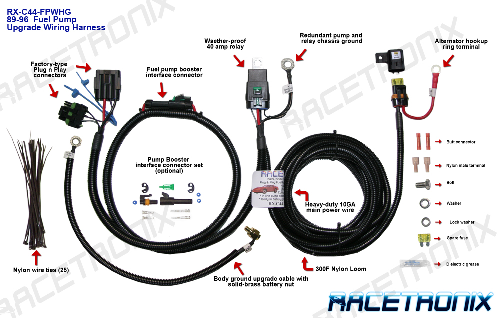

Shop called and getting ready to fire it up but can't get fuel pump to work. Years ago, I had the racetronix 244LPH Walbro kit installed. I can't remember if it uses the stock relays or if it has it's own in the kit. Anybody familiar with the system?

here is a pic that may help, It still uses the factory relays, but gets power from alt. There is a relay mounted near the gas tank now, and the fuse near the alt.

dont' have the link handy but the blowerworks site has a nice install manual as well

Perfect. Thanks guys!!
