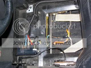

Okay... so here's a good one. A couple years ago (I know... I know... I'm just getting around to it...) I pulled the sport seats in my wife's '96 to clean the carpets. Ever since then the seat control works perfectly with the driver's seat but when you move the switch on the console to the passenger seat the lumbar/bolster's react to switch inputs as they should (passenger side), but the driver's seat moves instead of the passenger's. Any thoughts... please...

Simple answer, there are two electrical connectors under the drivers seat. Swap them. I know this for a fact because i did the same thing myself.

I had the same problem with my '96 sport seats when I purchased my car. BobRR3 is correct, there are two connectors under the driver seat and they will LOOK like they are connected correctly if you go by the wire colors on both sides of the male/female connector, but for sport seats that is not correct. If you have a FSM, look at the sport seat wiring diagram and note the wire colors entering and exiting the previously mentioned connectors, then compare them with the connectors under the driver seat and your problem will become obvious.
This exact problem is also mentioned in a troubleshooting table toward the back of the 1996 FSM, not in the seat section, I believe it's in the body section, ( sorry, I don't currently have access to my FSM).

THIS IS CORRECT, there is a controller box on the drivers seat that you can plug the wrong plug into, its looks and fits perfect but will cause what you are describing

I hate to bring up an old post, but this is the EXACT problem I've had since removing my sport seats.
I also have been too lazy to work on the fix. Can't control the passenger seat. I have the FSM which lists this problem,
but I am picture/visual type guy. Which are the connectors to switch out? The ones to the left, or that connect to the strapped switch/box?
Or under that? Help!

Just look under the front of the driver`s seat.There are two plugs that are identical.Just unplug them and switch the connections and your seats should work fine.The wire colors will be mismatched but that is the way they are from the facory.If I could download a picture I would show you but it is really pretty simple.It isn`t any problem at all.Let us know how it goes!!

It works now! Easy Fix! You guys are a great help!

Wrong! You don't want the plugs with mostly reds and yellows and the plugs with mostly blues and greens to match up.
Correct! You want the blues and greens to connect to the reds and yellows.
