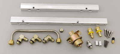

You can use all the TPI stuff(injectors, harness, T/B, and ECM) with a Holley Stealth ram and fuel lines if you have enough hood clearance. That will be a lot cheaper. $319+ $183 for fuel rails
You might also want to look into different injectors the factory Multecs are C**p. For that I suggest you see Jon FIC.
