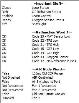

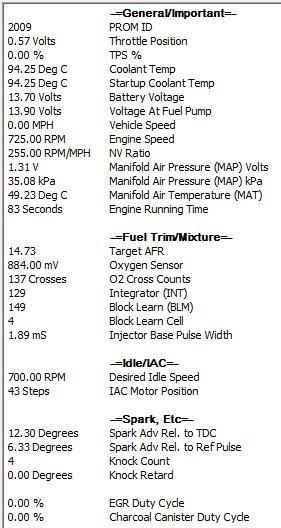

OK, (thanks to rodj and ch@0s in the other thread), I finally got my aldl setup working and got some info for both idle and 1900ish rpm, both at a stop. Unfortunately, my skills with Tunerpro are lacking to say the least. I can't figure out how to get it to export aldl values/flags to plain text, so here it is as images!
This was just after a drive home from work, mixed driving for about 15 mins. Shut the car off to run inside and get the laptop, plugged up, connected, fired up, logged. Also of note is that I have a hypertech prom from the PO, not sure if that means anything.
Idle:
Spoiler
1900 rpm:
Spoiler
First thing I noticed was the BLM was 149. I believe this should be 128, correct? I notice during the playback that the Rich/Lean flag is flopping back and forth pretty quickly, which I understand to be proper operation.
Also, I noticed when I started pressing the throttle with the pc connected that I got a SYS flash, then returned to normal. I also got a brief SYS the next time I tried to fire up, (then returned to normal). Is this normal when reading the aldl interface?
Also not sure about the "Malfunction Word 1", are these historical codes? The "No Reference Pulses" got me thinking... one other quirk of the car is that it doesn't like to start on the first turn; I usually have to crank it, stop, and hit the starter again. On the 2nd go, it fires up immediately. This happens even if I let the fuel pump cycle before starting. I had been thinking maybe this is a fuel pressure thing, but maybe the ecm isn't seeing ignition signal right off? Dunno, just speculating
Thanks for your help guys,
SB91
