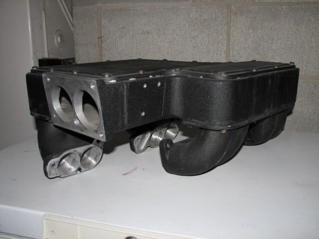

superram is a tuned port injection on sterodes. It has loads of torque from the low end to the top end because of the longer runners.
This is my superram I am putting on my 85 vette.

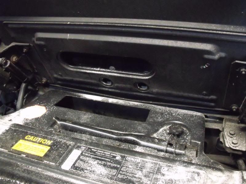

cold air mod is easy.
Just above radiator shroud you will see a oval hole that goes up into the hood. That hole feeds air through the hood to the CFI. Now look down at the radiator shroud. No hole there!... make one that matches the hole in the hood and your good. If I can find a pic I'll post it. or someone else will have one.
