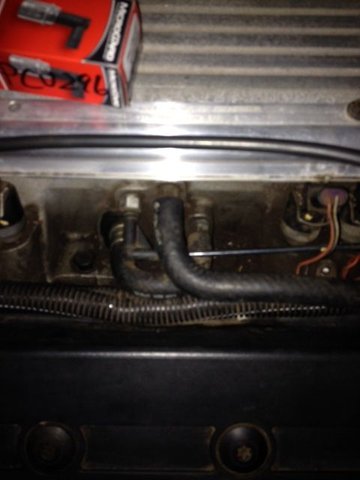

quick question and slight hijack, but why do some LT1's seem to have the PCV valve attached to a U shaped hose and going right back in to the next fitting on the intake, whereas the Chiltons and many other photos/info out in cyberspace show a t shaped fitting with an additional hose running to the front and attaching under the throttle body?
Also, I can't seem to get the hose off to replace the PCV valve? Do I just need to pull harder on the dang hose?

You need to NOT use the Chilton for reference and the Internet is --- "the Internet" - all true NOT. You need to get a year specific FSM for actual correct reference information and regardless of a whatever vehicle "year" generally matters. They ain't all the same!!
I would say you need a little more of a "tug" but I'm not there with hands on.

Same here, but I think the OP's problem is the other end of the hose where it goes into the valve cover. And this is where clean air vents IN to the crankcase, the other side of the intake manifold has the actual PCV valve, seen in my previous photo in post #7.
