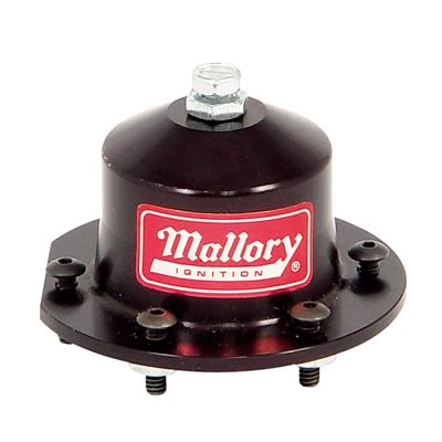

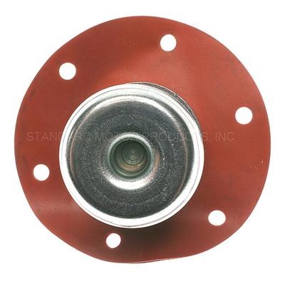

Your regulator is just a metal cap with a diaphragm that is the only part thet goes bad. Sometimes the Vacuum connector can break. Then you have to replace the cap.
Diaphragm
http://www.summitracing.com/parts/SMP-PR10
Cap Adjustable
http://www.summitracing.com/parts/MAA-4315/?rtype=10
How to do it
1. remove intake plenum, (top half of intake). Remove the bolts that bolt it to the intake runners. It may
be necessary to loosen the runners at the manifold to remove the plenum.
2. CAUTION!!!...... .. Release any fuel pressure in the system by pressing By starting the car with the fuel pump fuse pulled. Let the car idle until it dies.
the fuel rail (resembles a tire valve), and put a rag over the valve and cover it before you press on the
valve to avoid fuel being sprayed all over!!!
3. The stock fuel pressure regulator is located at the rear of the fuel rail. Remove the 6 torx head screws
that hold the stock regulator in place. 'This is UNDER SPRING PRESSURE. BE CAREFUL WHEN REMOVING
THE REGULATOR OR IT COULD FLY OFF!!!
4. Reassemble the regulator diaphragm and parts the same way they came out of the stock regulator
into the adjustable regulator and replace the 6 torx screws,
5. Reverse the plenum dis assembly procedures and reinstall the plenum with the gaskets supplied. It is
not necessary to use any type of sealer with these gaskets.
6. Connect a fuel pressure gauge to the Shrader Valve, turn the key on and check for fuel leaks. Set the
fuel pressure to the recommended 42-46 PSI by adjusting the screw on top of the regulator up or
down.
7. Two final cautions ....
1. Most of the parts that your are working with are aluminum .., THERE IS NO NEED TO OVER
TIGHTEN ANYTHING!!
2. Please take all precautions when working with any fuel system, IT IS FLAMMABLE!!!

You just order the diaphram and unbolt the top/cap and replace the diaphram. Doesn't take too long once you have the plenum off.
I believe you need a T10 security torx. You can get it at Autozone in a set. It will have a hole in the middle of the torx so you can take the regulator bolts off.
If you want to replace the fuel rail orings, order them from Jon. And get the 2 fuel line orings for the lines that bolt to the fuel rail from the dealer.
