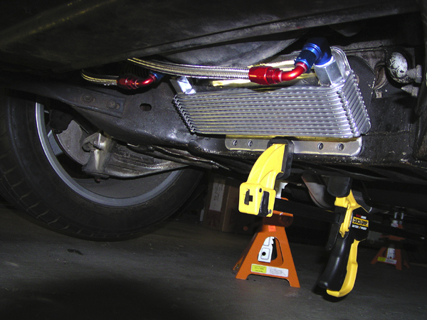

Mike,
I didn't like the idea of mounting the cooler to my A/C condenser and having the zip ties work on the aluminum fins so I had some brackets made and mounted a B&M cooler to the front crossmember where it's not in the way and still gets good airflow. I have more photos of the install if you need them.

Originally Posted by eguyett1985
Mike,
that looks nice

Originally Posted by Desert LT1 Vette
that looks nice
I wouldn't put the fittings like that, to easy to smash and lose oil.
