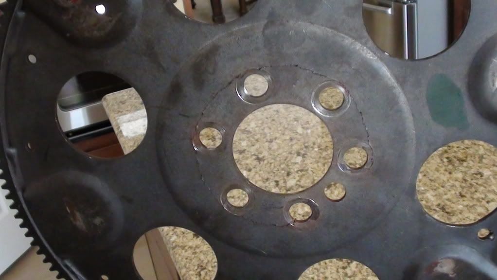

One more question do i have to move the tranny or do i have enough room to get it out by just removing torque converter bolts.

All that labor. Can anyone recommend a good flexplate internal balance 153t

You can push the torque converter back only about 1/8 of an inch without removing the transmission. You wouldn't be able to access the flexplate bolts with a wrench and definitely wouldn't be able to remove the bolts. The tranny needs to be pushed back about 3" at least. I use a Hays SFI approved flexplate.

Old Mar 5, 2011 | 02:15 PM
twin540's Avatar
twin540
Joined: Feb 2007
Posts: 740
From: San Antonio TX

Removal, Haven't done it on the Vette but did on an Impala. Get 4 grade 8 bolts 3/8 X 16 4 inches long. Remove drive shaft. With the trans supported remove all 6 bell housing bolts. Replace two lower and two middle bolts with 4 inchers. With TC loosened slide the trans back 3 inches. Keep it supported. R&R flex plate, slide trans forward bolt up. Might sound complicated but the method does work. I have done two like this, last one took something like 4 hours.

I have it out i'm just trying to find the best one for my application.
