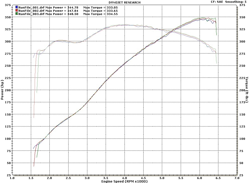

Finally got the dyno chart. I don't like the dip in the early RPMs, but like my buddy said, the hot cam is a mid range cam, so what do you do?

My 95Z had the hot cam kit and Mac mids. Dyno graph was very similar - had the same dip @ 2700

have a 96 LT4 with a Hot Cam; nice to see some numbers for this combo.
