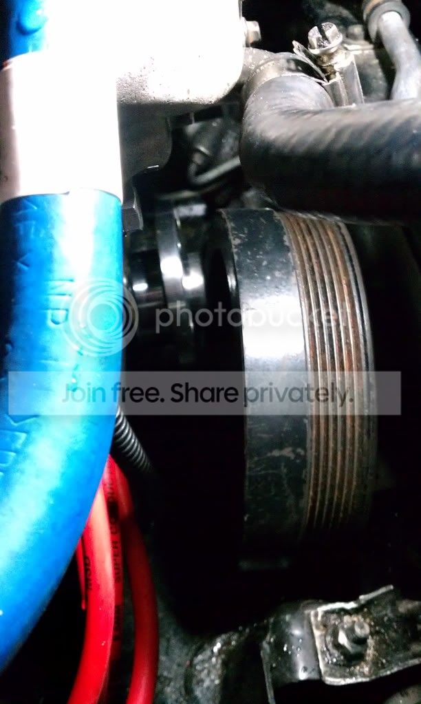

100% for now I'm using my stock balancer, with the billet hub.. till a vender gets there yard stick calibrated..
Tada no engine lifting or removing rack. just had to drill a pilot hole.. the hub has a roll pin
