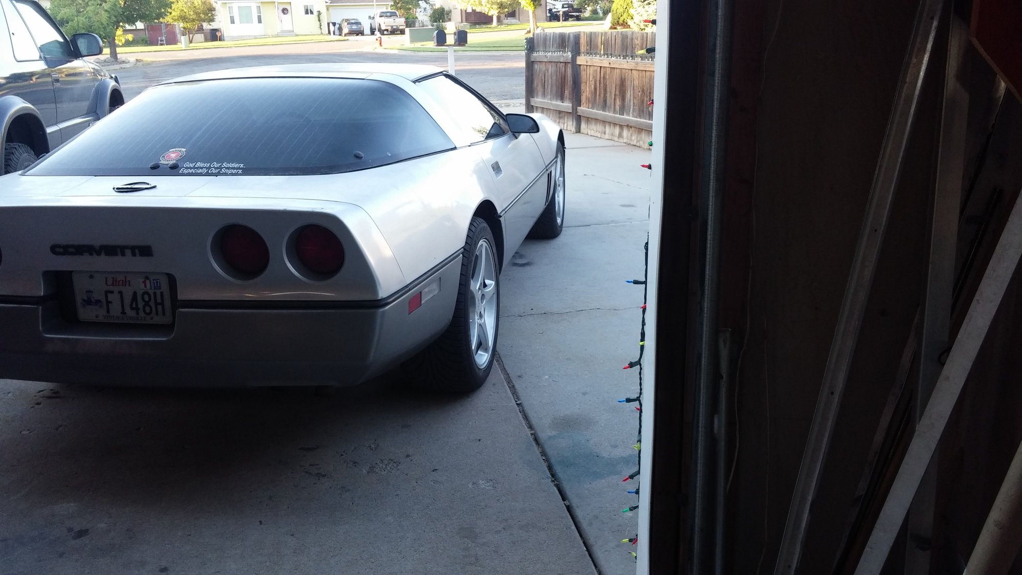

I have 1in wheel spacers on my car for c5 wheels, brings them almost perfectly flush with the body.
You can kinda see it in the pictures, i have space to go a little bit wider.
​​​​​​​Did you have to modify the lugs to fit the 1" spacers? My studs are 1.1 " on my 85.
Old Jan 8, 2017 | 08:44 PM
Gibbles's Avatar
Gibbles
Joined: Mar 2015
Posts: 1,275
Likes: 165
From: Utah
Nope, standard lugs.
Oem wheels also have some space in that area, so if it stuck out there would not be any issue.
And my car is an 84
