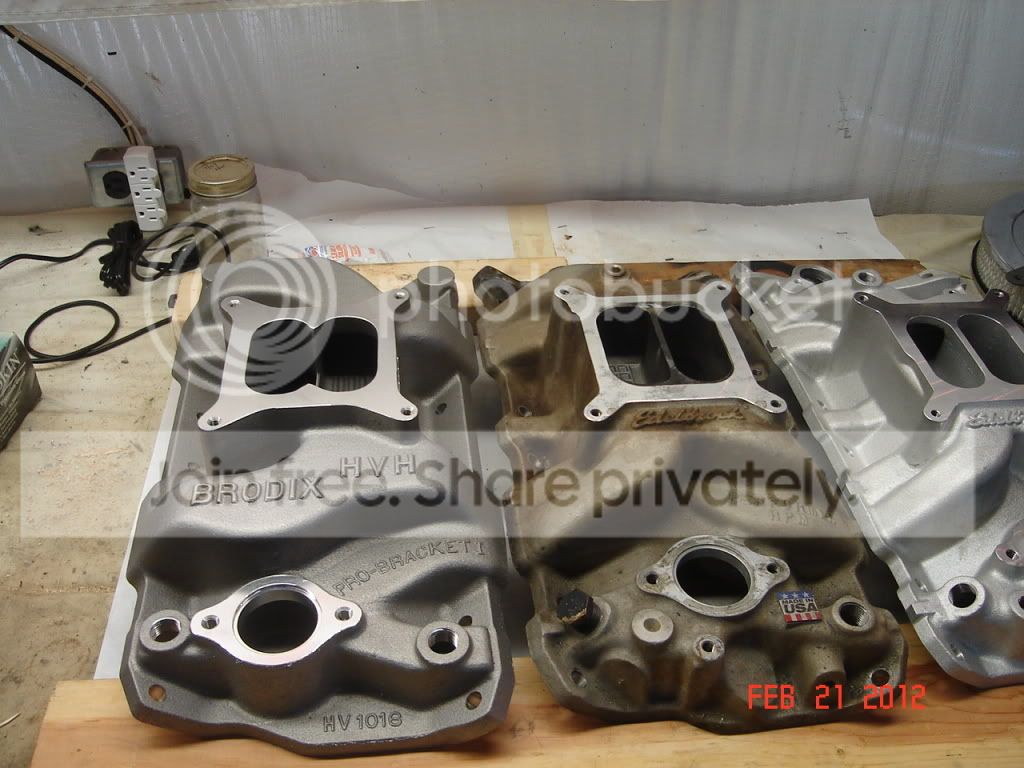

you mean this Brodix ? A lot of talk online about it being shorter but it is not. I got excited and bought one only to find out it was taller at the front of the carb pad which is where it matters on a C4 because of the way the hood slopes.

Performer EPS... I know, I don't like it either, but I am going to have to settle for now.
