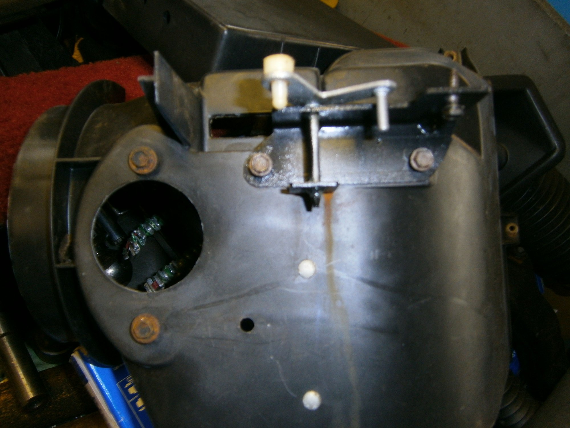

I think he meant the bell-crank on the heater box that the cable attaches to. That's where mine was frozen.
Don't go by the colors. I cleaned and painted mine while I had it out. A little oil on the vertical pivot pin freed it up.

I never thought to give that pin a hit with oil when I had it tore apart. Although without the cable attached but the rod to the vent door attached, I could move that v-bracket easily. I was actually surprised at how little effort it took. Probably should have sprayed the vent door hinge too but like I say it moved easily. I'll give that pivot pin a good bath of WD40.
Hopefully that loosens things up.
