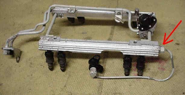

are you familiar with the ninth injector? Previous owner might have removed it. Mine was leaking so I deleted mine. Takes a little extra cranking to get her started now. It's on the drivers side and injects directly into the plenum-look for a small metal hose coming off the back of the fuel rail to the injector. If it's not there, that could be causing your long crank time. That injector is only on the old C4s, it shoots a small amount of fuel directly into your intake, kinda like spraying starter fluid into the intake, to get things started more quickly. You don't have to have it (they tend to leak after a while) and you can't buy a new one, to my knowledge.
Just a thought.

Are you referring to the "cold start valve"?
Sure, this thing:

Sure, this thing:
Yes, known to be problematic on early BMW models too. It commonly leaks and are many times eliminated. Thanks for the tip.
