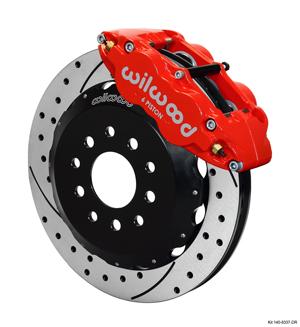

Can we talk more about retaining a parking brake and upgrading the rear brakes?
I will be going with a willwood kit and need to upgrade the rear but would like to retain a parking brake if possible.
Dependent upon your stock rear brakes. The "drum in disc" stock set allows for the full big brake experience, whereas the stock. dual purpose or 'combo' caliper does not. The 88-96 guys seem to get the short end of that deal.
Earlier cars with drum in disc have the full line of rear kits with four pot calipers etc.
But even with the combo caliper in use you still have the option of obtaining matching 2pc rear rotors to accompany the front kit.
For "needing" such things and all....that's in the eye of the buyer. But for all you get- under $2000- it's pretty hard to argue against it from a value standpoint.

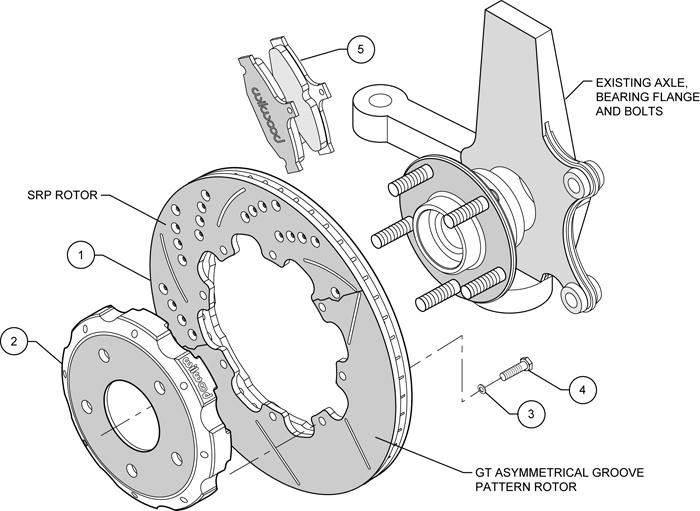

Parking brakes are not unreachable at all. There are two types- drum in disc and hydro-mechanical. You have the latter and sadly the poorest design for aftermarket. It's a dual action caliper- take it off and install a four pot caliper and the p-brake is forever done.
From the other side of things in fact the drum in disc is superior in many ways. For us in the aftermarket it's the only way to go allowing consumers to have their cake and eat it too. Yes they are heavier as the hat is not aluminum but iron. But mated to the big rotor and paired with the four pot caliper it's the better braking system you're looking for.
On a car with out this feature (yours) you remain stuck with a single piston, dual action, sliding caliper. Of course it works well- it was intended to do exactly what it does. But removing it and fitting a larger disc is out of the question. *Unless someone has fabricated a Caliper Relocation bracket to pair with the larger mounting needed for a bigger rotor.
Two totally different designs. Both effective. But only one allowing the fit of a big brake kit.
LATE CAR:
EARLY CAR:
ALL C5/C6:
Unless the rear uprights can be swapped out to the early design drum/disc set ups I don't know of a way around this.

So my 85 wwill be fine with the stock p-brake and the 4piston wilwood kit? If so I am sold on the whole kit.
With an '85 you should have a drum in disc now as shown in the second image. You an easily verify that by checking that the parking brake cable goes to the small drum at the center and not to the caliper.
From there is simply a matter of picking a kit you're happy with and spending a few hours installing it.

Originally Posted by Todd TCE
Seems simple enough. Even a guy like me picked up some info. I'd have sworn the mount holes from the 4 to the 5/6 were not interchangeable- good note to self. If the price is right it may be a fairly straight forward deal. And it would appear that the cross fit will only allow for 13" but not 14" fit, right?
I'd still say $1500 or so spent on a full kit would be a better deal but I'll admit I'm biased there also.
You are correct, the mount holes are not the same. An extra set of adapter plates are required to interface between the C4 spindles and the C5 brackets. That + the requirement to use larger wheels drove the cost up too high for me. I just used the setup I posted above and am happy.
Old Mar 18, 2014 | 10:52 AM
  #60
Todd TCE's Avatar
Todd TCE
Supporting Vendor
Joined: Jun 2008
Posts: 2,204
Likes: 119
From: tempe Arizona
Ahh...Thank you. There just seemed to be something amiss here on this cross fit idea. Not having one of each at hand I was going on some old history of doing a custom deal on some C4 spindles as well as there being no cross fit in parts from the Wilwood factory kits.
