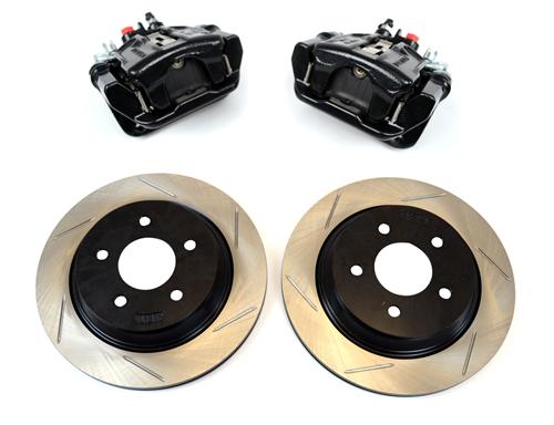

I bought out some brake parts from a shop and ended up with 6 sets of these calipers and brackets, several rotors, and some other little stuff. There are no more available where I got mine. Mine are lacking any markings other than the PBR patent numbers. The Mustang PBR brakes say COBRA on them where the GS calipers say CORVETTE. Mine are identical to the GS calipers in every way except color and markings. I've also seen them with BAER and SSBC. I have the correct Corvette brackets that have a fancy zinc finish.
I still have 2 sets of the calipers/brackets for sale in the sale section.

I'm quite confident those calipers in your image are mid '90s FOMOCO and should have 38mm pistons. The mid '90s FOMOCO stuff had no embellishments.

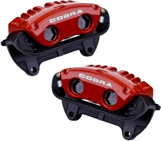

The Mustang GT used a caliper that is totally different in design and mounting. The Cobra used the same caliper as the GS except it said COBRA on the side where the GS says CORVETTE. I've also seen BAER and SSBC on what appears to be the same calipers.
1990s Mustang GT calipers
Several companies appear to use these same calipers. If anything, mine look closer to the Baer than any of the others.
Mine fit a Corvette
