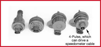

The VSS is on the transmission LH rear on the tail-shaft housing, it's very accessible so the change can wait.
The VSS will look like the one second from left in this image:
In this image it's the "white" part on the rear housing
