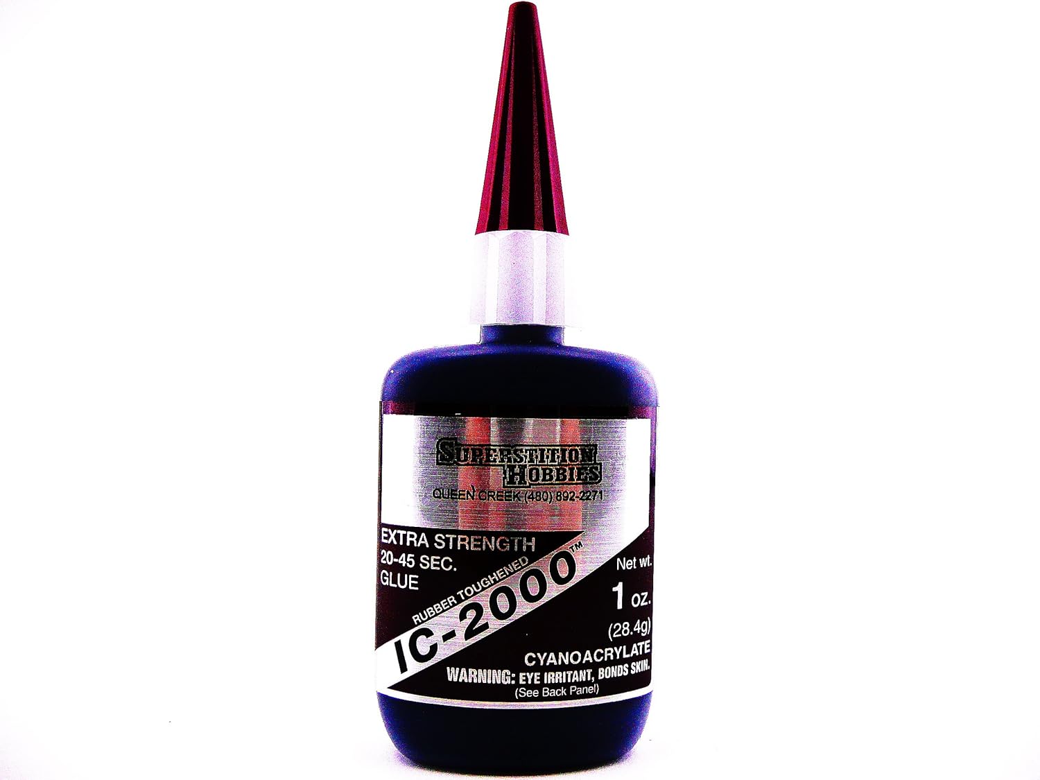

I heard from my vendor to use thick CA glue (super glue). I had some around that is used on RC car tires. Worked like a champ.
Wilcox replaced my first one after it parted at the joint (couple of months old). The rep told me about the CA Glue in case it happened again (it did).
repaired the hatch WS on my 90 with CA held up just fine. BTW, it is available in BLACK -
