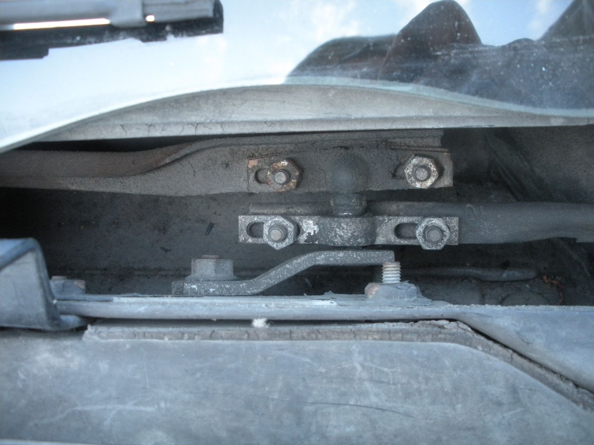

You can probably eliminate crashing wiper blades and blades hitting the pillar posts by adjusting the sweep of the wiper arms. The adjustment is under the vent screen, below the windshield, above the wiper motor.
