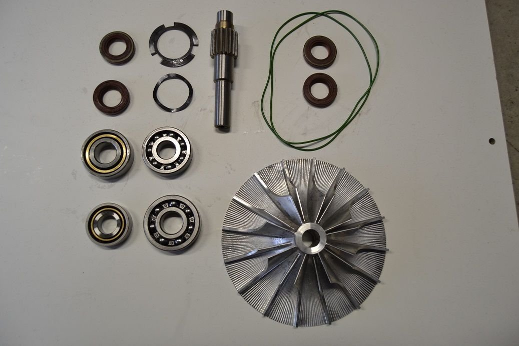

My goal is about 400hp using P600b. Now I have 330hp.
Here is the current situation...I need first build my head unit...

Next coming:
-rebuild P600b with billet D1SC impeller
-Aquamist methanol/water injection
Let see how I can get all those working in future...

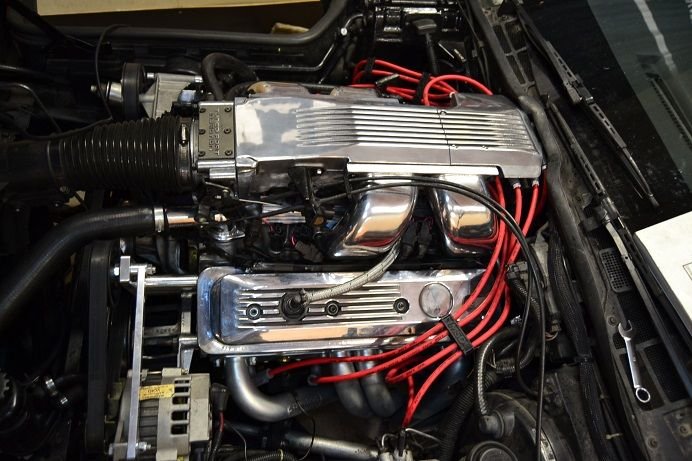

I´m installing Procharger P600B unit to my automatic 85 Corvette. I have now L98 TPI MAF engine, better cam, headers, 113 alu heads, 1.6 rockers, SLP porterd runners and plenium, 34lb EV14 injectors, 2,5" exhaust....dyno tested now 324hp.
Also I will install Aquamist HFS3 methanol / water injection system. I am planning to use 50/50% water and alcohol.
I have also all electrical gauges which needed. (fuel, boost and AFR wideband)
Next, I need help to choose right valve to my supercharger.
Is the Procharger red race valve right one?
Or the Procharger surge valve?
Thanks,
