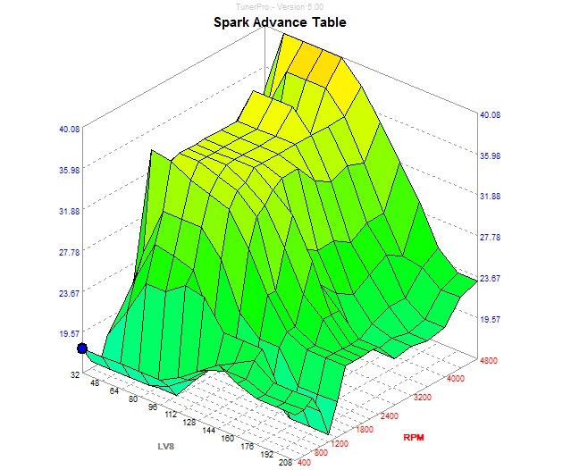

Anyways just for kicks i copied the SA table form the AUJM into my ARAP bin and burned a chip.....WOW....very nice idle improvement over the stock ARAP...pretty comparable to the smoothness i get with my $32.
I running slightly rich at idle AND LOWER rpm now (124 BLM ) due to the new table i guess?

I dont know...car is running well with the spark table from the AUJM bin...idles pretty good..i just have not seen such a "mild" SA Table before...see pics for the Table numbers and graph
[IMG][/IMG]
[IMG][/IMG]

Actually mr *****'s...i have tried that step with inserting the table from my BUA9340 into the arap bin. But that particular SA had been modified a few years ago by PCM4LESS. the "customized" table is just as aggressive as the ARAP stock table. I never zeroed out the ARAP's power enrichment spark advance though.
Tonight, I copied the SA table from my stock BUA9340 bin and pasted it into the ARAP...ZEROED out the enrichment table for all RPM fields...put the chip in fired it up...took it for a short run...did not datalog...car ran nice...idled pretty well, but the engine was already fully warmed up. Will fire it in the morning and take it for a run...maybe do a datalog also to see whats happening.
