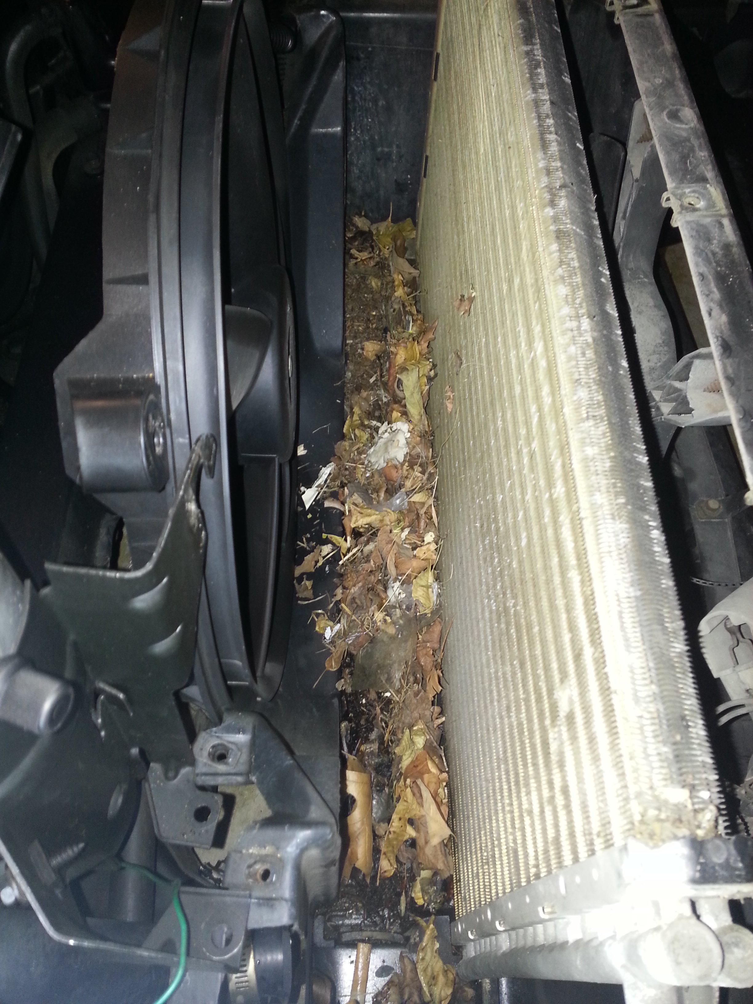

Replaced my radiator recently in an effort to get it to run cooler with a Dewitt's double row aluminum radiator. As many have stated previously I found half a forest trying to catch a ride.
After cleaning:

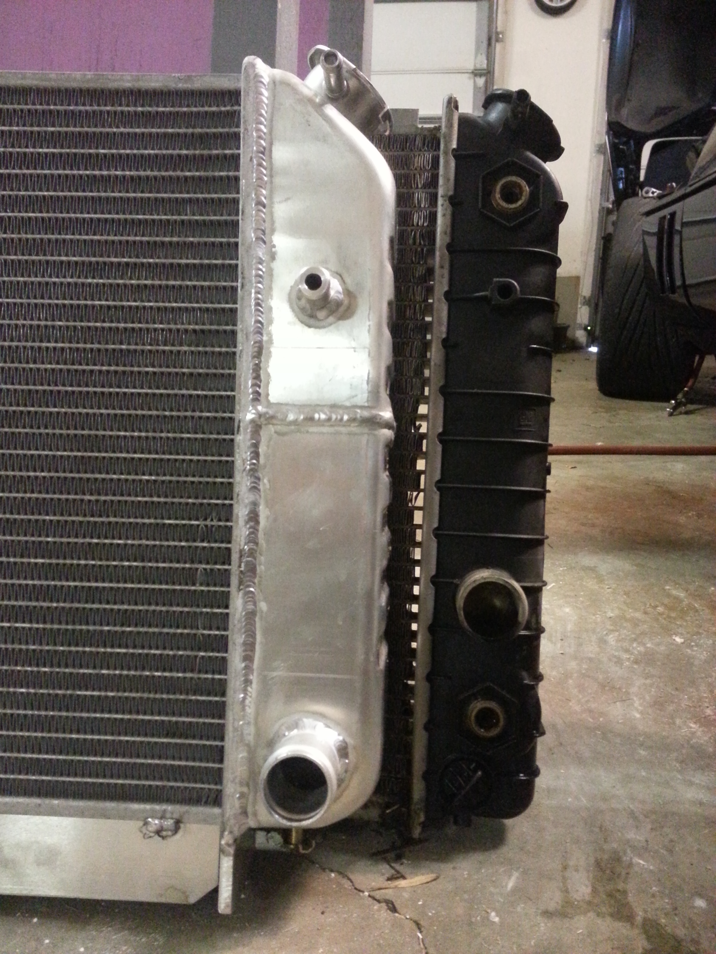

After comparing the new radiator to the old, the bottom hose mount is located lower than the original.
This bracket needed to be cut:
Once trimmed, the radiator fit nicely:
Top Bracket also needs to be cut:
Initially I used a dremel, but a utility knife worked out a lot better.
In looking at Dewitt's website, the radiator pictured for a 1989 doesn't appear to match the one I have. The lower hose mount looks like it would line up without the trimming. Perhaps I have a different version than what is sold now.

The radiator you bought is about (7) seven years old. That design was one of the first (prototype) units we built in 2006. It used a shorter core and the bottom had an air baffle, which makes it look like the lower connection is lower, but it's not.

The 85 uses the fat condensor, to those that didn't know this. Our rubber cushions are designed for adding our radiator and the thinner condensor used on 86-89 cars. Since jmrl98 stayed with the (Fat) original (28 year old) condensor, the cushions didn't work, but they do work perfectly on all 86-89 models. I will modify our details on the website to mention the 85 model.
The 90-96 model is a completely different radiator, and we do not supply rubber cushion with this model. The upper cushions require some trimming and a sheet of instructions is included.
