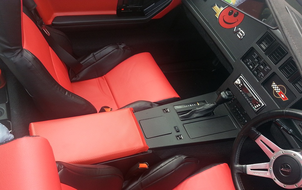

Bought it six months ago... great machine... worked on the interior...

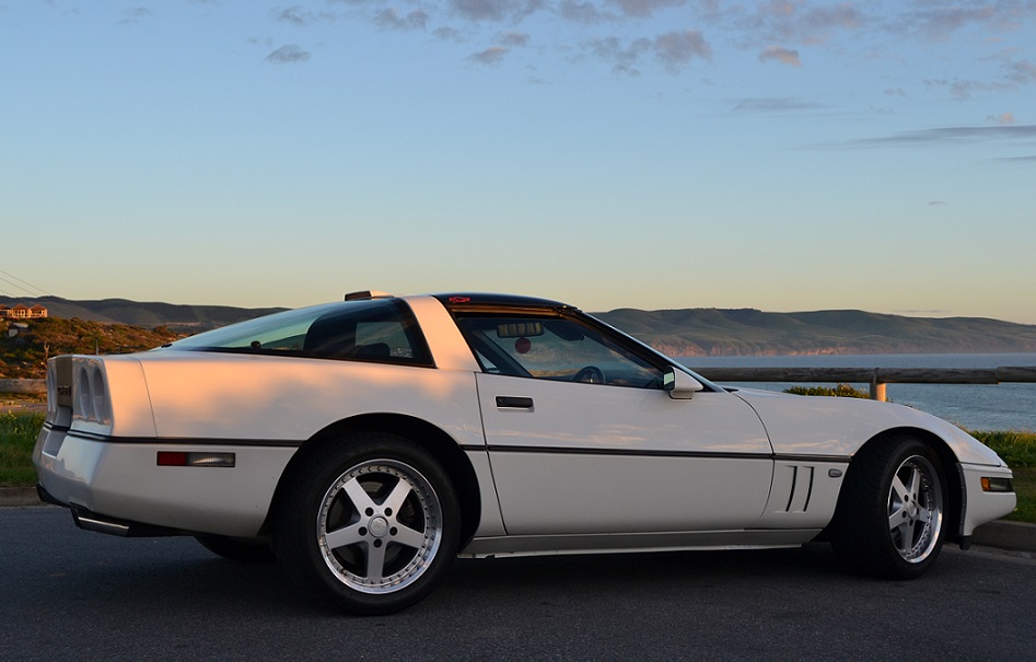

Either you are a professional photographer or that is a great looking car... Maybe a little bit of both but very cool pictures.

No, not a professional photographer... far from it... the car is as good as it looks... goes great too... everywhere we go people come up and look at the car... even shout out at traffic lights and where-ever we stop.
