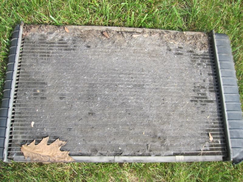

Originally Posted by sheppard1
I too have a super charger and intercooler. I get way too hot in 90+F. I have a 11" two puller shrouded fan with the fans hooked together. My fan doesn't come on with the a/c so I think I'm going to add a 12" pusher to the condenser to turn on when the a/c is used. Can you tell me the reasonable operating range for the L98? Seems nobody knows for sure around me.
There are so many C4 owners that get freaked out if their temp hits 210. It's NORMAL!
If you have a clean radiator, you usually won't have heat problems under normal conditions.
If you are regularly 220 and more, your system is dirty and the radiator needs to come out to clean thoroughly
240 and more is when this needs to be done now
normal I'd say is 190 to 210

I'm constantly over 220 around 230-237 with all cooling fins clean in the heat with the double puller fans running. They are Derale fans with the automatic speed controller. I'm hoping that the additional 12" fan will keep the temperature in a more normal temperature range. It never got hot until I reinstalled the a/c after the supercharger installation.
did you take the radiator out to clean the fins? If you didn't they are still plugged up!
