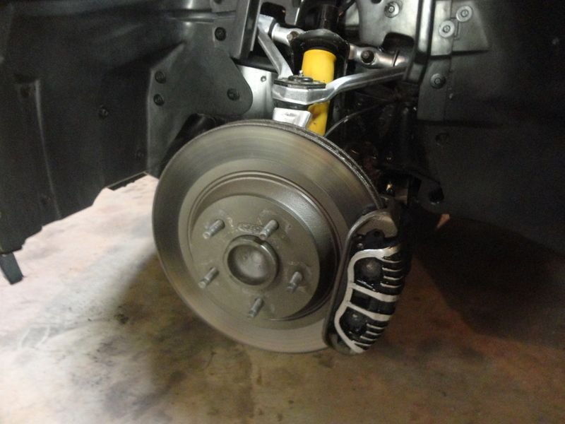

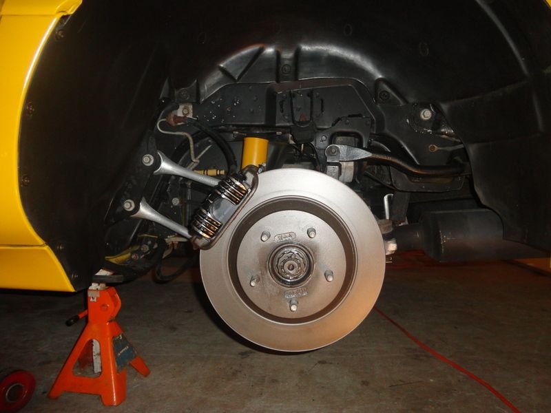

Here ya go....Hope this helps. These are J55 front 12" rears
Rear
Front
