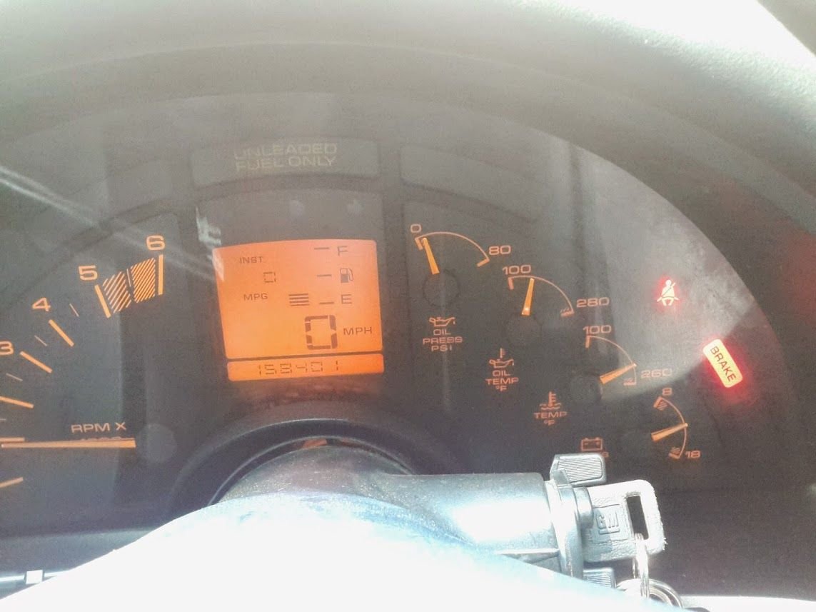

Well, this is interesting. Now, running for less time than it did last night, oil pressure dropped down dangerously low. So sometimes it happens, sometimes it doesn't. And the engine was cooler when it happened than it was at idle last night.
Here's a picture of my gauges.
Old Aug 1, 2014 | 06:24 AM
  #33
playsdixie's Avatar
playsdixie
Joined: Jun 2013
Posts: 1,590
Likes: 60
From: ft myers FL/Munising MI
Originally Posted by C4ProjectCar
I did turn the screw. The plug was missing, so I believe it had been adjusted previously to solve the low oil pressure at idle.
Yep, I plan to look for vacuum leaks as soon as I have the time.
What's TB? I'd heard to use carb cleaner.
throttle body cleaner.....you must do the minimun idle adjustment...you have messed yourself up turning that screw....then set the tps....it will not run correctly until you do...you're wasting your time chasing low oil pressures at idle. it's outlined in your fsm, there are threads explaining how to do it on this forum.....
