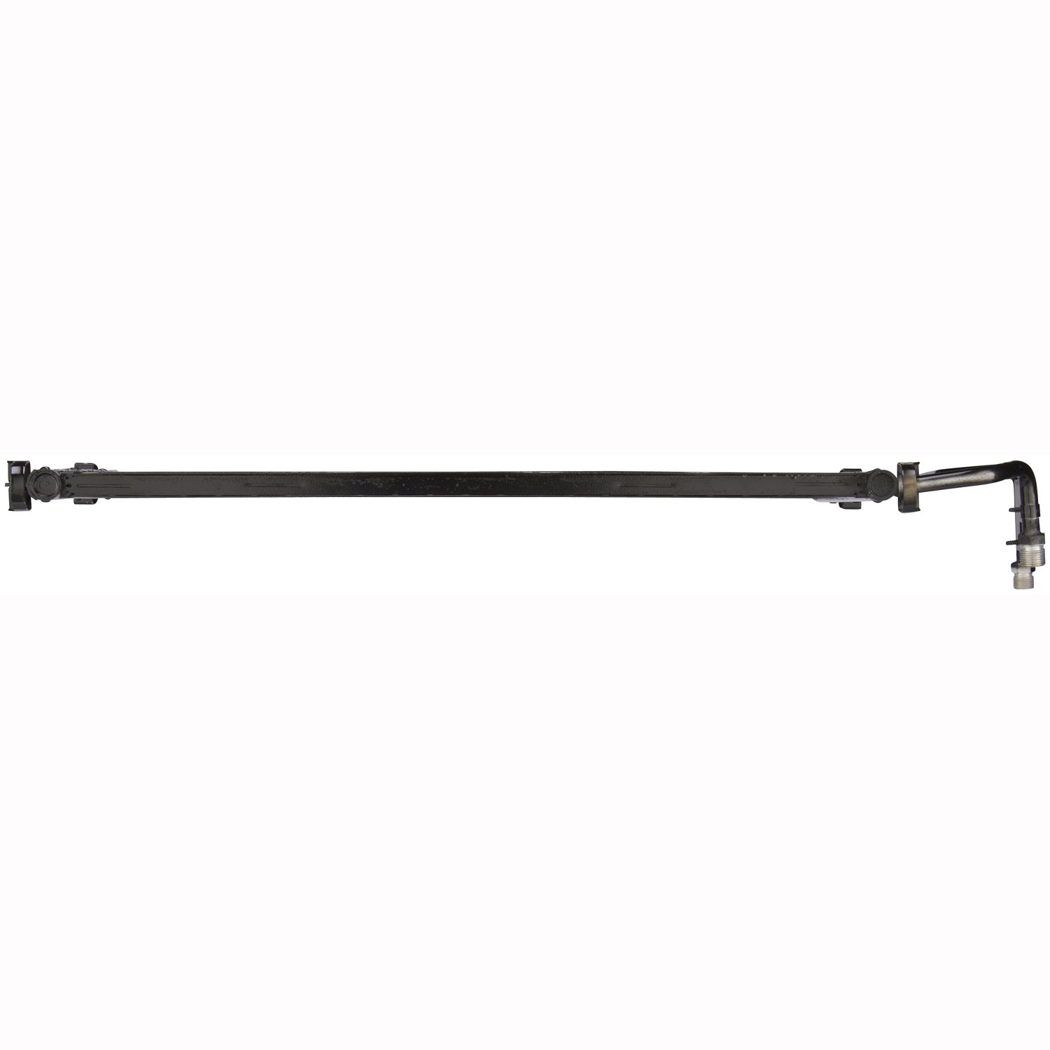

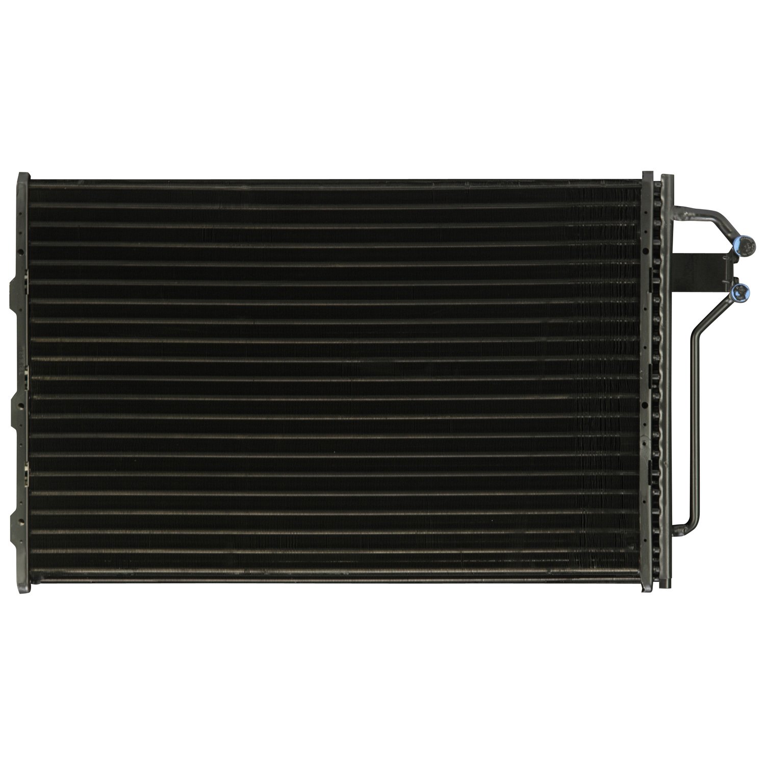

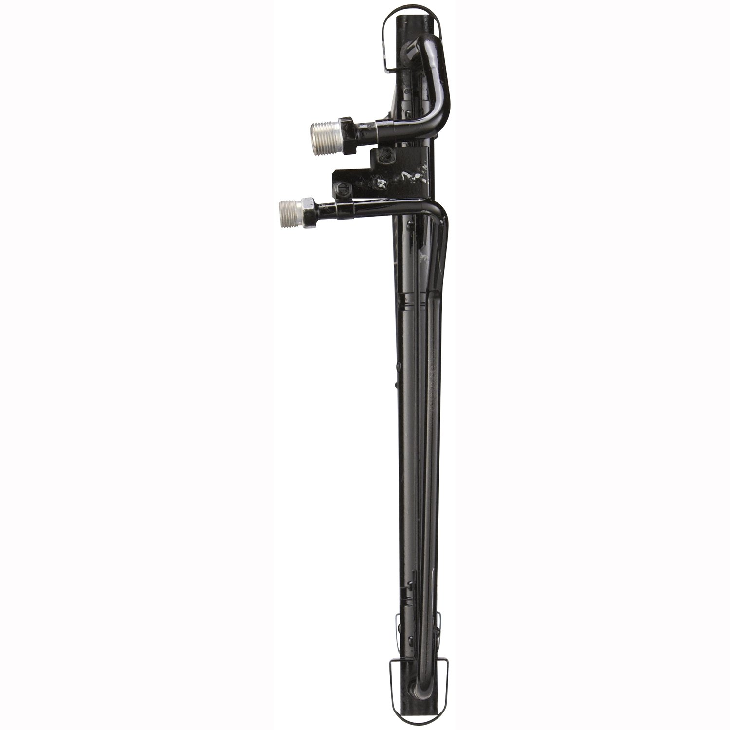

My OE condenser has a small leak in the lower RH corner, so I decided to replace it. After doing a lot of research, I discovered many (if not actually all) of the aftermarket condensers are smaller...and not by a little, by a lot! The most notable dimension is the core thickness...the original core sits at 1.25" and the replacements are .75" thick. The core width and heights have been downsized on the new replacement units as well...
Believing that these new smaller condenser wouldn't be as efficient, I found one I thought was correct from RockAuto.com PRO 7014020 with the correct dimensions...and it even looks to be constructed like the original.
SO I bought it...and what shows up? The new "downsized" version....swell. In fact, the new one I received is the same size as the Spectra Premium listed below the Pro unit in the link above.
So my question is: Will this unit perform as efficiently as the original, or should I send it back? RockAuto already said they would accept it back on their dime since the catalog shows a different size unit than the one I received.
Here is a comparison of OE (TOP 2 pics) vs. Aftermarket unit I received. Notice a difference???? Think size matters?????
