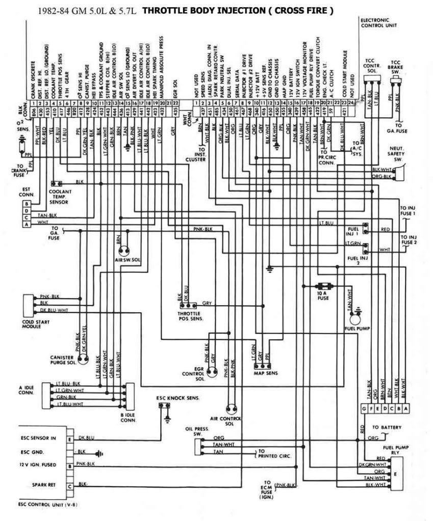

Isn't there a way to do it through the Aldl connector?

This is all I can find..

And again, you ground wire 422 with a switch, and it comes on.
You can wire the 4th gear switch (Which I don't see?) inline there also.

If I am reading it correct it looks like 422 goes to the Aldl connector pin f and pin a is a ground and should activate it then. Right?
