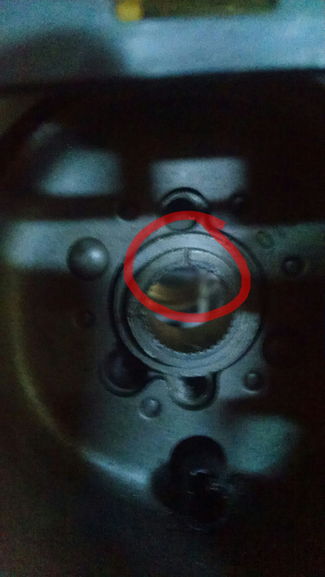

Old Sep 1, 2014 | 12:14 PM
chipsc4's Avatar
chipsc4
6th Gear
Joined: Sep 2014
Posts: 6
From: Long Island New York
im guessing that these are said alignment markings??
