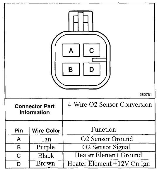

Also I've seen that those heated sensors have 2 wires . My 85 has only one .
Any ideea on where to plug the second sensor wire ?
Thanks.
Thanks.
Single wire has only sensor data. No power to it and no ground since the threads are the ground. 3 wire sensor has a heater and a ground. 4 wire has heater, 2 grounds and sensor data.
