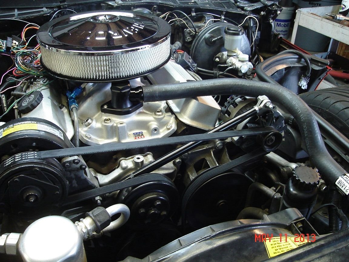

Default Air pump Delete
Here is how I did it with no extra pulley. All components are running in the correct direction. It requires a 2" spacer, an 84.5 belt and I angled the thermostat housing and used the original belt. If you don't tilt the housing up the belt rubs the radiator hose. The spacer and bracket for the alternator are from Summit Racing.

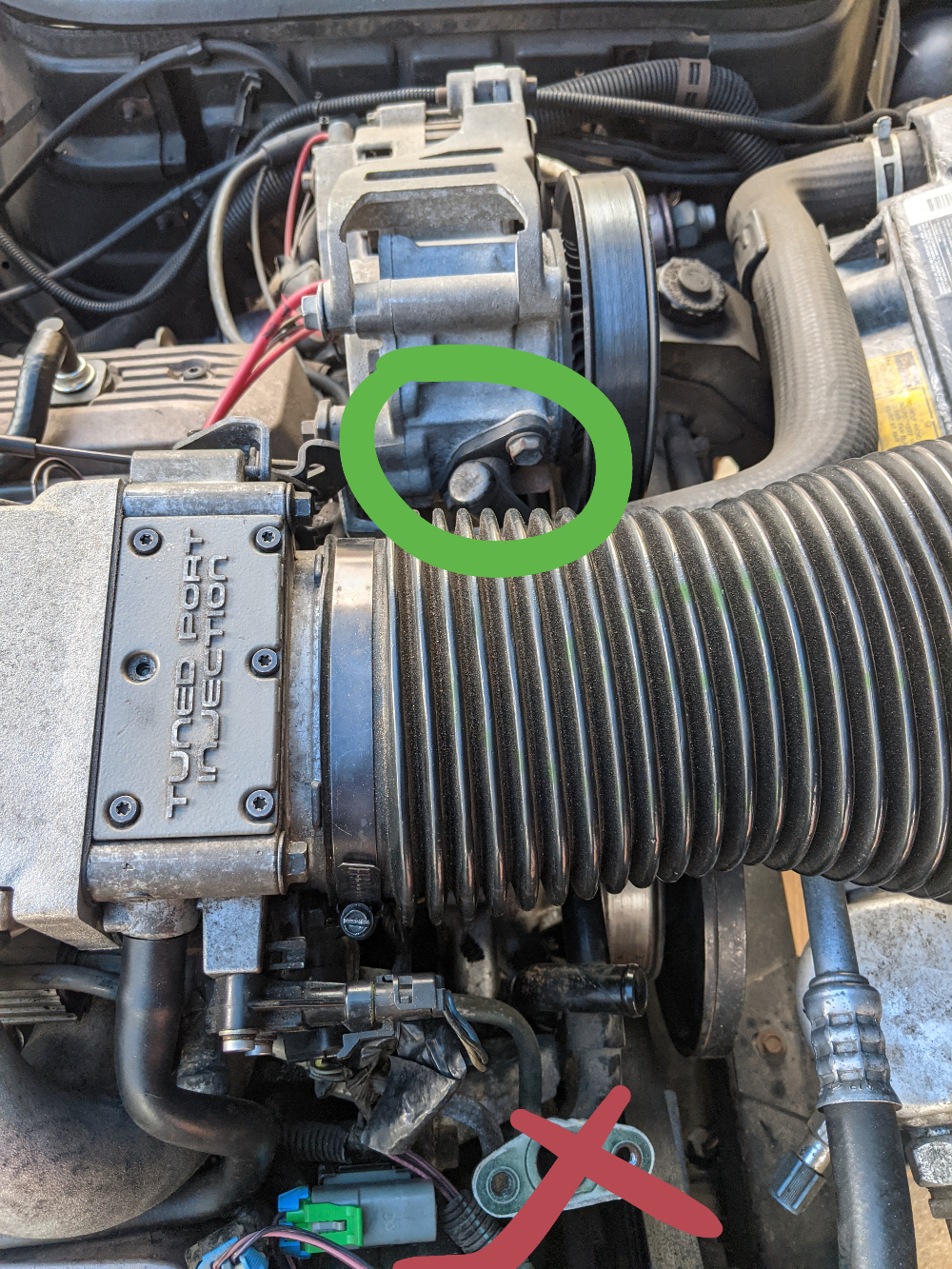

Hi, sorry to revive this thread. This response is the closest I have been able to get to what I am trying to do. My question is, if I remove everything AIR pump related, can I leave the pump and just cap the one port that goes out of it into the metal line (held by two screws on the right side of the pump) and let it run or do I NEED to gut it also?

Yes the aftermarket bracket and pulley are the go to recommendation but the only benefit I'm interested in is clearing up the engine bay. I'm wondering if the drag is the same if I cap off the pump as when it is working, or if there is an increase in resistance from being capped off with nowhere for the "pumped air" to go. If it's the same and I'm only missing out on the power gains from a freely rotating pulley, I would rather keep the stock pump and only remove everything else. But if the drag gets worse on a closed off AIR pump then I will have no choice but to gut it and look into getting a delete kit. Thanks for your input.

I made my own, wasn't expense or hard to do...and looks alot cleaner
