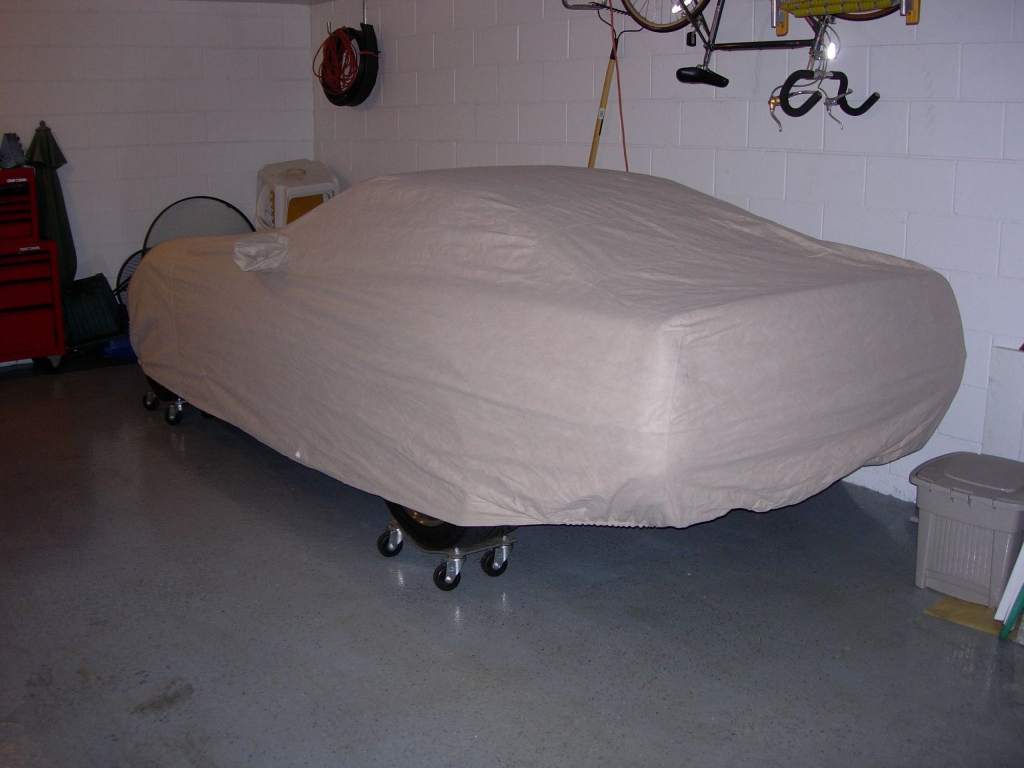

In addition to what was mentioned above, I pump up my tires to over 40 PSI, and put some large desiccant bags in the interior. I also stuff steel wool in the exhaust tips and place open containers of cut-up Irish Spring soap in the engine compartment (mice supposedly don't like it). I also put my car on dollies so I can roll it nearer to the wall. And a car cover, of course.

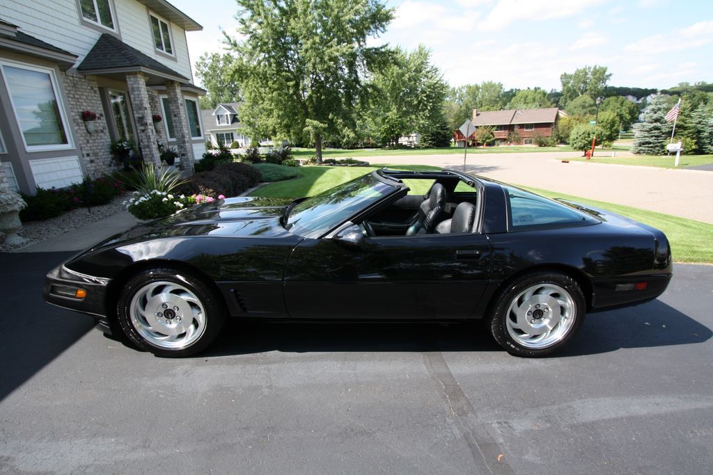

My '96 is just basic black, a dust magnet:
