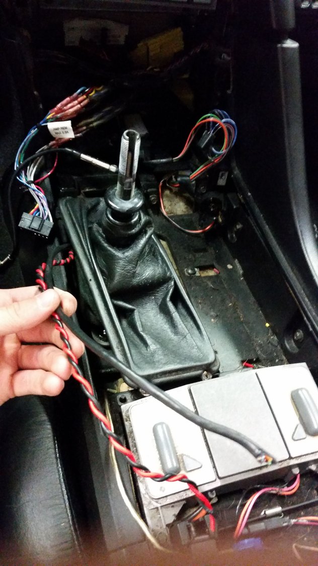

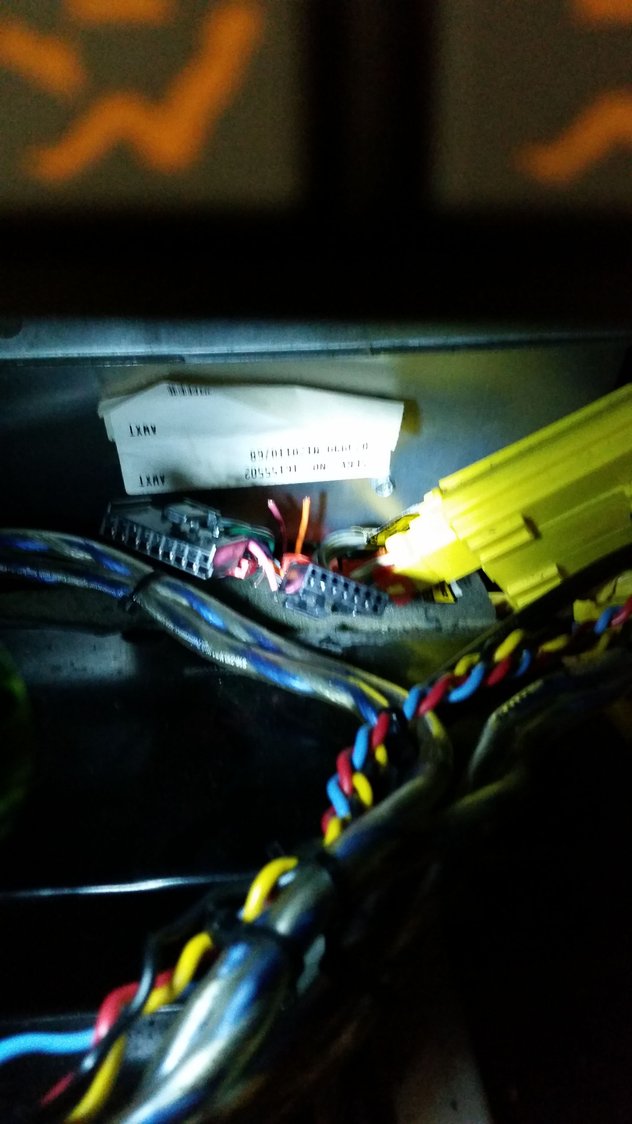

So after taking the center console apart to get the aftermarket radio out, I discovered that this car is a bit of an electrical hell hole unfortunately. Check the pics: note the weird stray wires that run into the center console and are just cut at the end (red and black twisted pair, and the larger black cable), the audio cable that is spliced into the rear hatch release wires, as well as the stray connectors in back of the radio area which themselves have wires cut (there was even a very loosely installed wire nut type thing holding two of the cut wires together, even though neither of them were stripped back). Very odd indeed.
Regardless I still re-ran the test after I had the radio out. Results were the same as before, 1.5A parasitic draw.
Another thing I noticed was a little LED light wedged between the dash and the driver A-pillar...something like a security system LED? I dunno...
Electrical issues definitely arent my strong suit but I want to get better at fixing them. However all the shoddy work done to the car makes me want to just gut the whole interior right now... Those mystery wires are really gonna bother me until I figure them out. I really wanted to just get it running right first so I could drive it around a bit. Decisions decisions...
