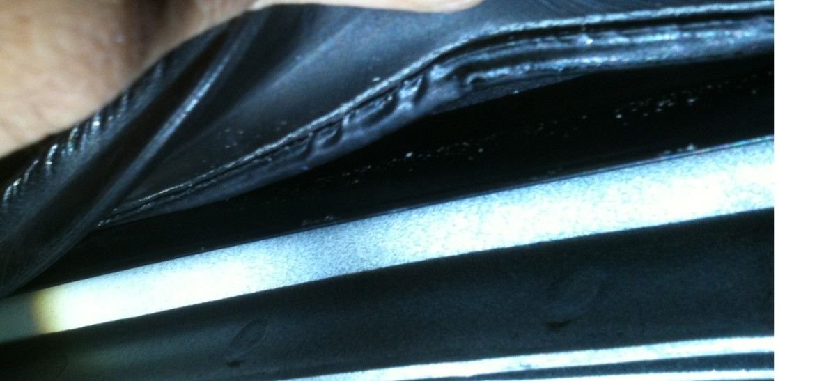

Thanks for the input to all - it's really good to get some advice. I have not worked with weatherstrip before.
I took off the a pillar plastic trim (had to remove the top trim just to get the side trim to come off - included removing the rear view mirror and the sun visor). As far as I can see, the bottom of the weatherstripping comes out of the channel by lifting it up with my thumb. The top of the weatherstrip isn't moving at all when I pull on it - seems pretty stuck in there. So, I don't know how that comes out (glued, non glued, pinched).
I read about retaining clips and possibly some metal bar, but don't know where those are. Are those clips supposed to come off before the weatherstrip comes off?
Also, I see these black plugs at the very top and bottom of the a pillar weatherstrip (photo). On the very bottom of the A pillar, I do see some evidence of some black adhesive (door jamb). What are these plugs (are these the retaining clips?).
The last photo is of the dents courtesy of some moron that I must find. If the car was a total mess, I might live with it.. but it's in GREAT shape for it's age (unlike its owner)
Thanks for the advice and ideas.
