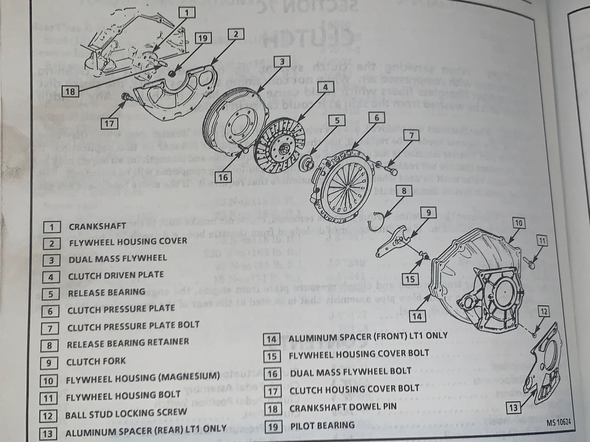

Originally Posted by Iceweasel
Did you use the spacer plates as shown on page 7C-2 of the GM manual? Please contact me at your earliest convenience. I’m stuck on my swap.
You you can message me quicker on Facebook messenger if you have it
www.facebook.com/heymomtheupsguyishere
It's to isolate the magnesium bell housing.
