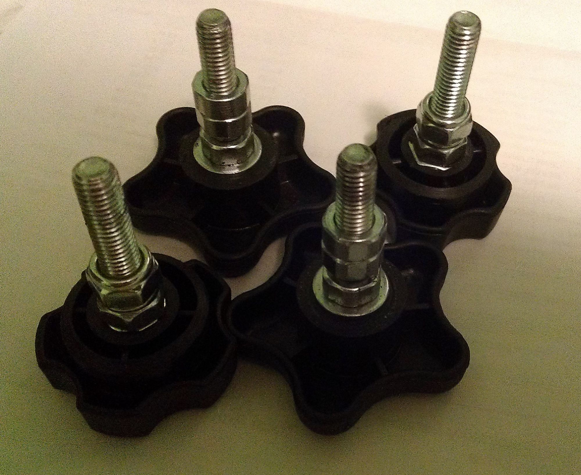

Madmax032, Looks like you went from the bicycle seat tightener for the rears, to ***** like the fronts. Any particular reason and... can you get them tight enough by hand?
Sorry for the late response:
I could not get the rear ***** tight enough by hand to prevent them from loosening themselves. The top creaked and popped when I had the ***** in the back too. While the front ***** work fine, I still would rather switch to the bike seat binder clamps, though I haven't designed those front ones quite yet.
So, the bike seat binders worked best for the rears?
The reason I asked is, based upon your original posts, I ordered six of those bike seat binders from your Chinese connection. It took SIX WEEKS for me to receive them and now I'm not sure, based upon your most recent pics and posts if they're worth using. Thanks in advance for your continued input.

Cool idea. I had the same issues with my 86 coupe. I used an allen wrench best I remember when I first bought the car as it didn't come with the tool either.
What I went with later that solved it for me was a lithium rechargeable ratchet I bought at walmart. Kept it in the storage bin in the hatch area. I could pull the top or tighten it down about 60 seconds if I was in a hurry. Zero effort and it never backed out on me when I used it to tighten the bolts down.

Yup, me too. Have a Ryobi, a couple of B&D's and a Harbor Freight special. However, having spent some recent time in C5's and C6's, I've been looking for a more "elegant" solution. Don't think there is one... think you've got it right, Crowz!
I ordered another set of the binder bolts from that seller and I think that they took almost 4 weeks to get to me which is pretty sad, let alone 6 weeks which is terrible. Fortunately, they all look good so hopefully I can create the front ones this week...
edit: I just realized that I may have misled you with the front *****. I originally made ***** for front and rear but being unhappy with the rear ones, I created the binder bolt solution. I just have not gotten to replacing the front ones with binder bolts yet, though the larger front ***** work well enough as is so I am not rushing.
