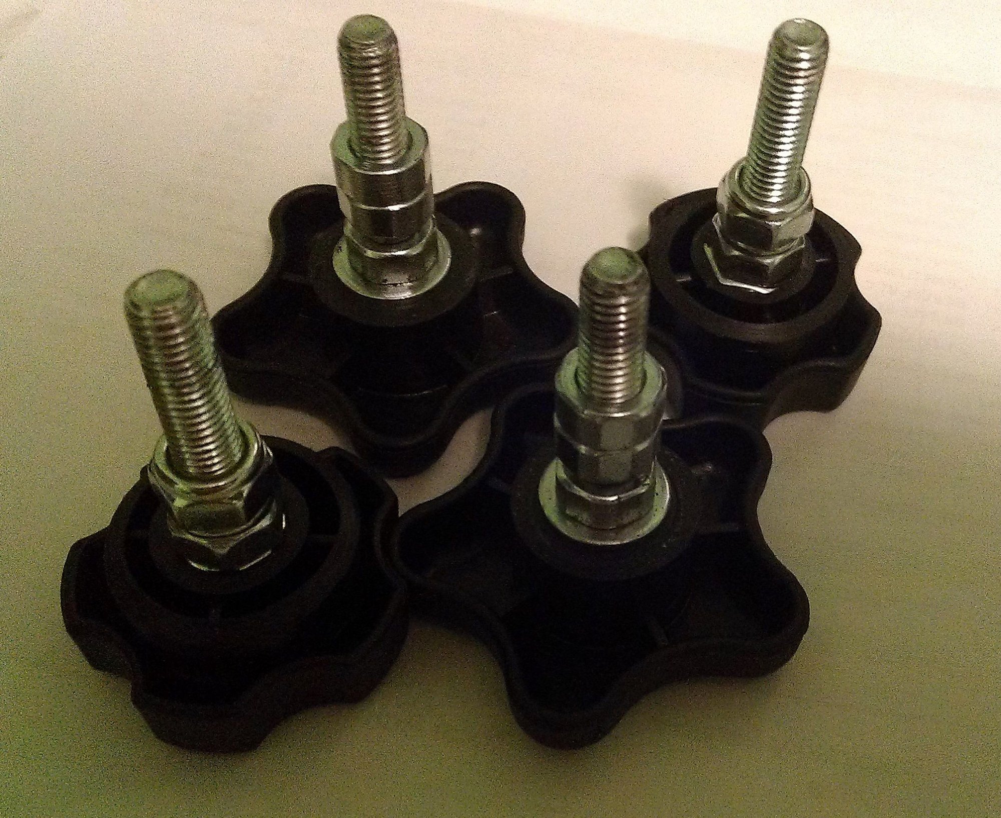

Having purchased a 94 Vette with no with no hardtop wrench included, I used a cheap torx wrench to remove and reinstall the hardtop. That was a somewhat annoying and cumbersome process so I decided to follow a tutorial for creating hand-tightened ***** for the hardtop from this example:
This is how they turned out:
The larger, flatter ***** with the triple stacked nuts and the ground nut corners go in the front and the smaller ones went in the back.
The setup looked great but unfortunately, I could never get the rear ***** tight enough to stop creaking, popping, and loosening during driving.

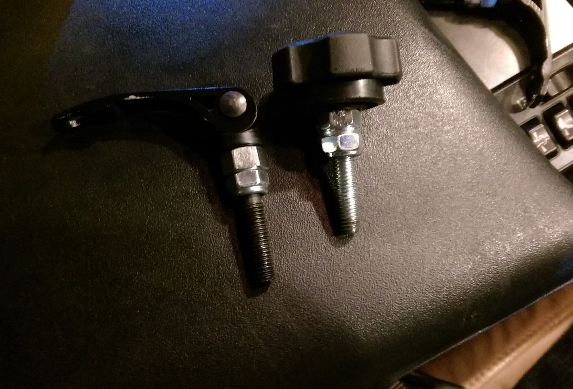

That's when I took a look at the seat height adjustment clamp on my bicycle and got an idea. After searching the web for some "quick release binder bolts", I finally came across some M8*1.25 x 60mm ones on ebay for a couple of bucks each.
I slipped a large nut over the bolt up to the clamp area and slightly drilled out the threads (stopping before the nylon lock) on lock nuts so I could thread them down the bolt then push them onto the unthreaded section. This keeps the 2 nuts from falling off the bolt when the binder bolts are removed from the hardtop but allows the bolt to slide through them when the quick release is locked down.
New vs. old
Now, the rear is nice and tight, doesn't self loosen, and has a cool quick-release functionality and look to it. Combined with the front *****, I think I have a winner! Anyone else done something like this?

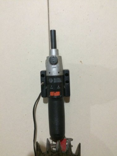

I don't want to steal this thread, because it truly is a good idea. I'm just throwing out what I did years ago to get away from the factory ratchet.
Too many years ago, I picked up a simple B&D electric driver, dirt cheap refurbished even. And bought off the "tool truck" a long-ish T40 bit. It worked great for what it was. My old B&D died last year (yes, it still hangs on the wall) but the newer tool offerings are almost as cheap and quite a bit more advanced. T40 sized tool bits are cheaper and easier to locate today too.
Bosch TX40201 2-Inch Length Torx T40 Power Insert Bit - Screwdriver Socket Bits - Amazon.com Bosch TX40201 2-Inch Length Torx T40 Power Insert Bit - Screwdriver Socket Bits - Amazon.com
I don't pull the roof off anywhere near as often as I did years ago but I'm over due for an upgrade.
