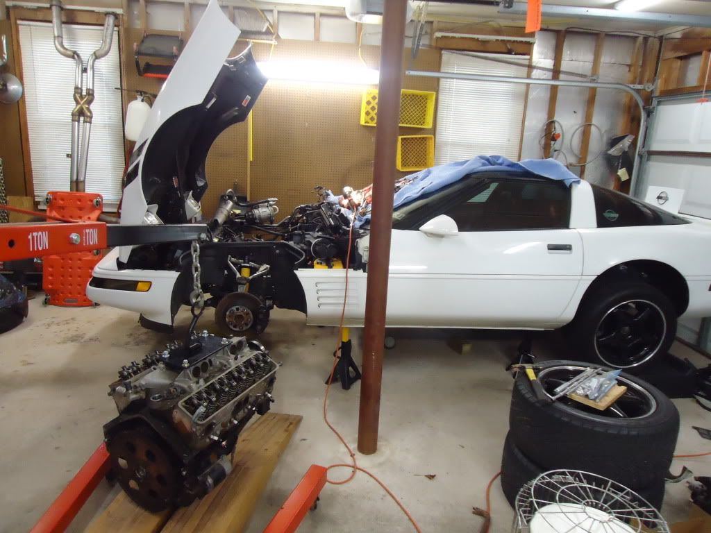

I used the adjustable engine leveler. Also, .be aware of how high you have it on jacks..I had my car high enough on for 6T jacks..that I could "comfortably" work underneath. This, of course..impacts how HIGH your crane has to lift the engine to clear the car.
And the engine leveler will make installation way easier...

I also needed the chain on the back of the drivers side head and front of passenger side head or it hit the bulg in the firewall for the electrical bulk head fitting when the engine was tilted back. I noticed that putting the engine in the car... For some reason I was unable to get the engine in the car (by myself) with both engine mounts attatched to the engine. I have done it before but I just couldn't get it done this time without beating the crap out of everything. I also found that if you have a spare set of valve covers that can get scratched up, put those on as well.

I waited until I got the trans and the engine mated to put on the engine mounts. Made sure the engine did NOT rest on the oil pan. Could not mate the trans and engine without doing it like this. Was also limited to only two hands. This is why that engine leveler comes in handy.
