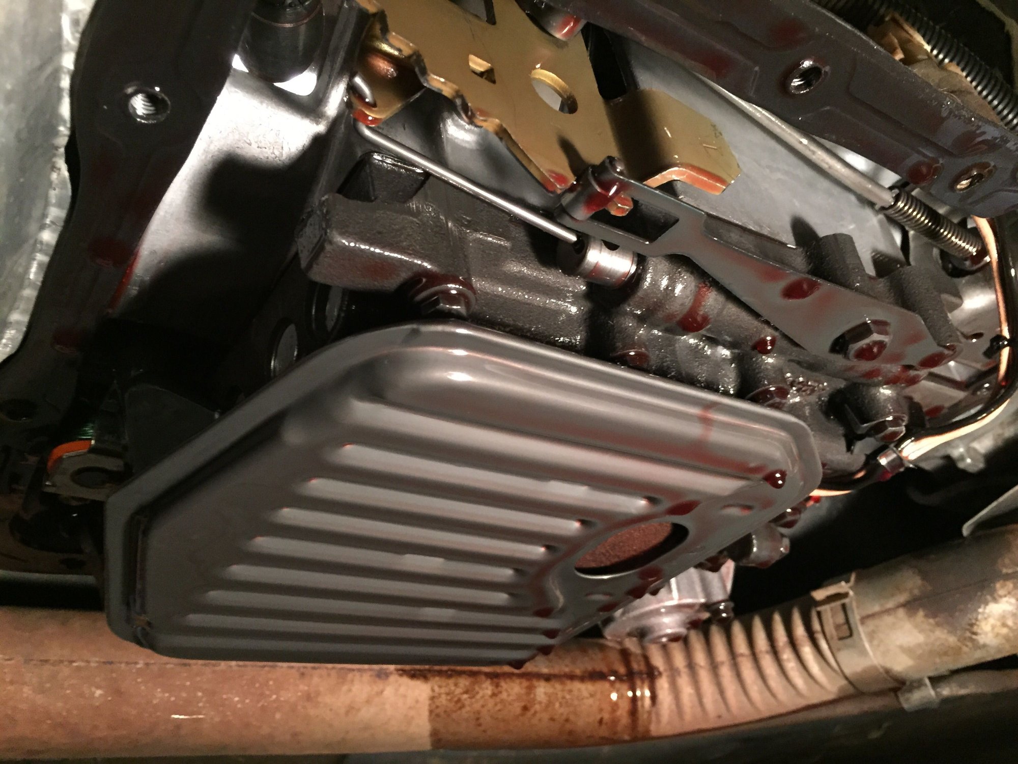

im guessing this is some kind of bushing or seal that is leaking from the rear diff.
I am about to drop my exhaust from the cat back, to replace the tailshaft bushing and the seal, which is leaking.....so, i would like to deal with this leak in this picture at the same time.
This is all new to me but I'm figuring it all out and enjoying it. This red 85 has gone from leaking everywhere to having only these two spots left that are leaking.
Any ideas what is causing this leak?
I will google and search the responses and teach myself how to fix it.
I do have the shop manual for the 87 (my other vette) but not the 85.

That is the pinion seal that is leaking.
Pretty simple to replace. Proceedure would be the same as listed in your 1987 shop manual.
You might also want to look at replacing the inner stub axle seals.

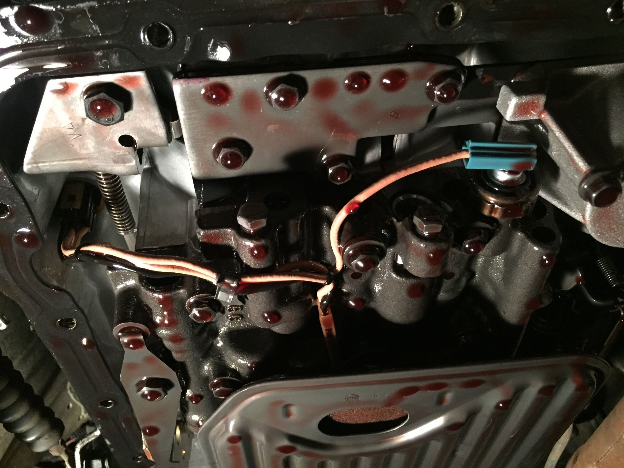

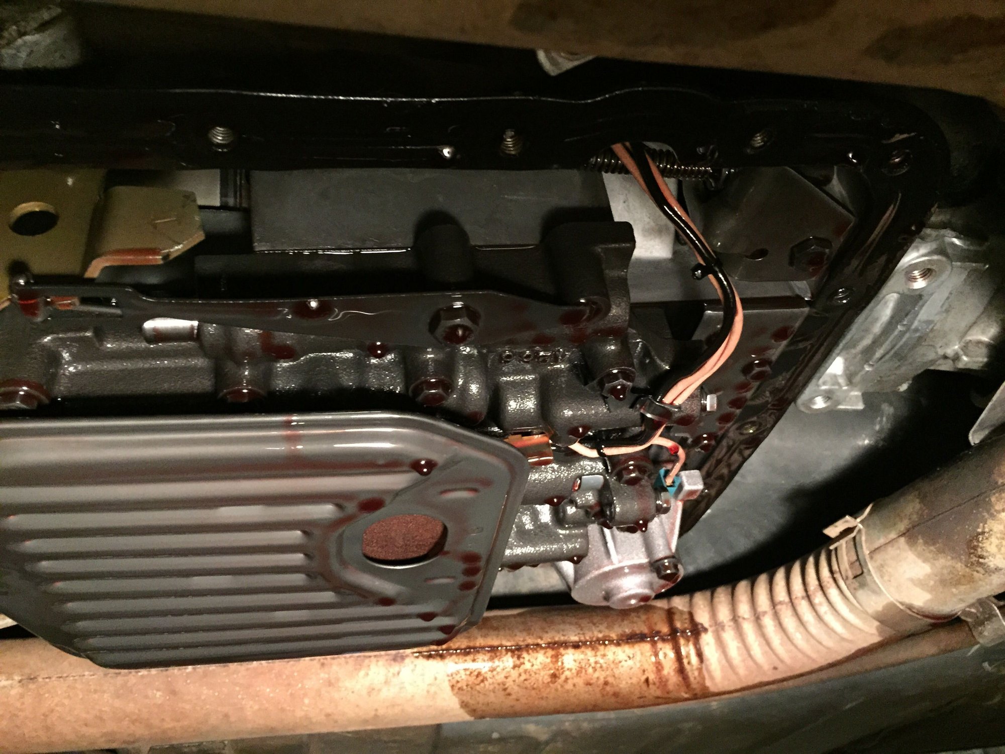

Moving forward....here i dropped my tranny pan. Dirty job.

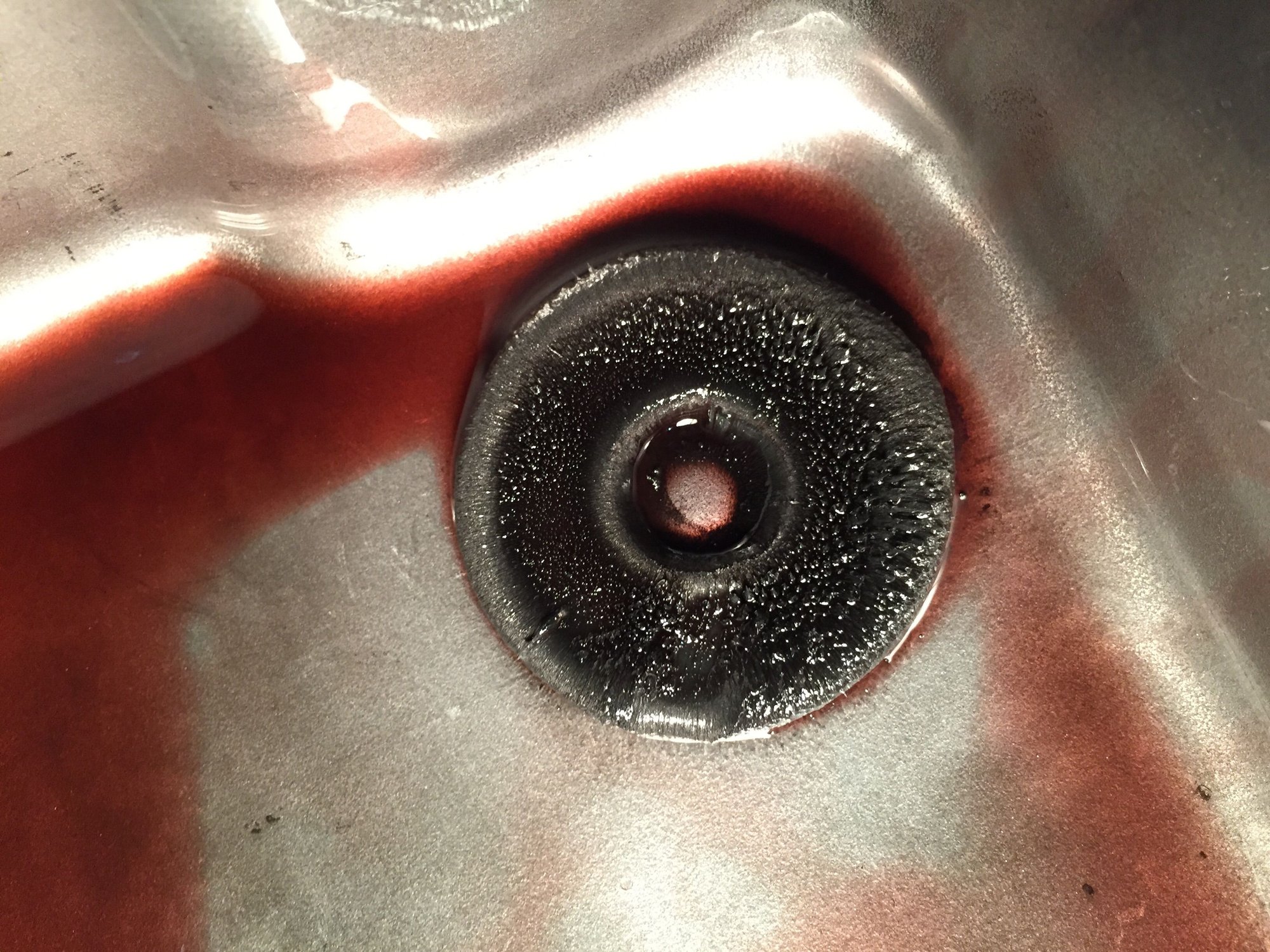

I have what looks to be a sludge donut blob thing and there looks to be a magnet holding what i can only guess are metal bits? there is nothing big, does it look like standard wear?
i decided to do a drain and refill on the tranny becayse i was under there anyway ablut to do my tail shaft bushing/seal and the diff pinion seal.
I bought fta dexron VI to fill.
while I have this pan off should I replace a filter?

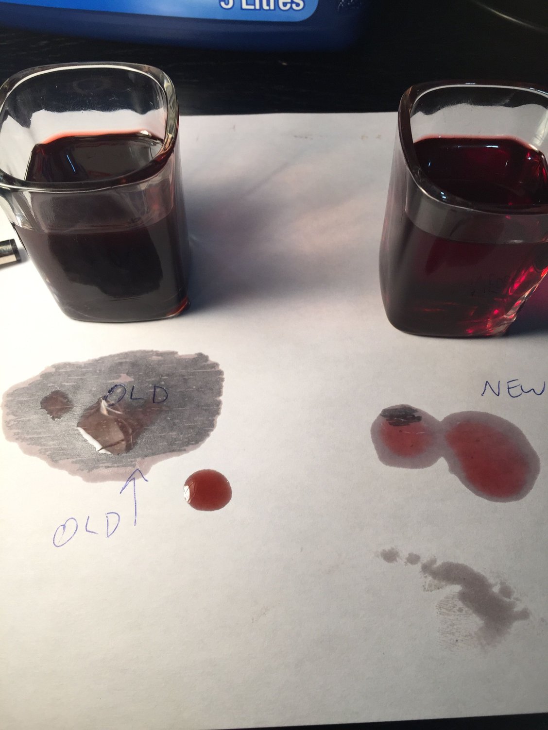

This is my first look inside a tranny. We bought this red 85 auto with 40,000 miles on it. When i dropped the oul pan, there was not a drop of varnish or discoloration and it looked good.
how does this one look to you guys?
learning as I go....thnx.
they are very close but the old stuff is darker.
sludge donut? should i wipe this out?

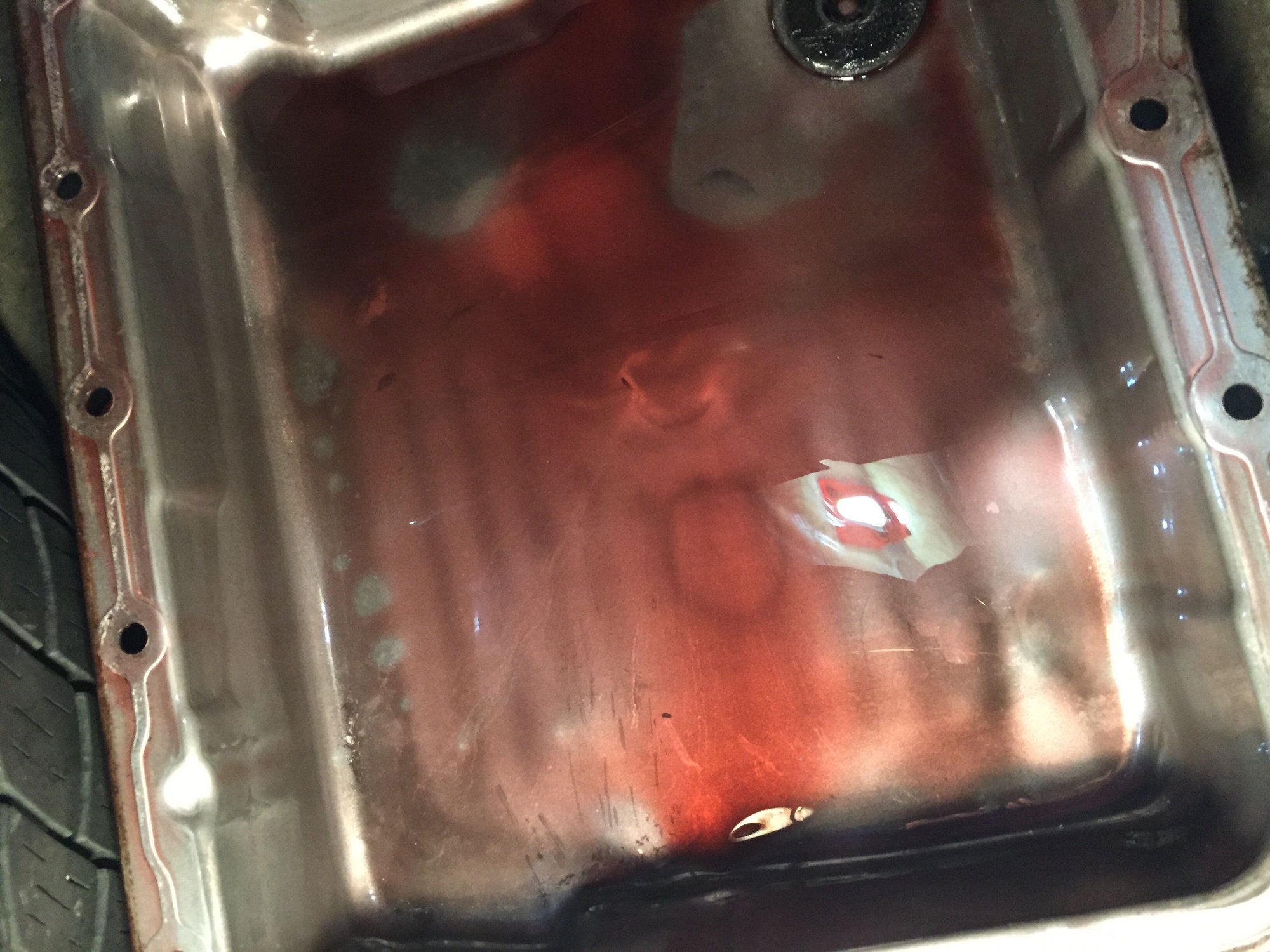

look at the pan. there were no chunks. nothing.

Pan and everything else looks OK considering the age and probably mileage.
Wipe it out. Clean the metal off the magnet.
Yes, I'd put a new filter on it.
Will

there are so many myths about age of trans fluid... so many myths...
so little truth...
1. ATF ages, get over it.
2. ATF changes colours, get over it.
3. The two above do not equate trans rebuild is needed.
4. Metal shavings are a natural result of transmission function, get over it.
5. Shavings do not equate trans rebuild is needed.
The only thing that requires a rebuild is when in "D", the trans shifts from 2nd to neutral. Otherwise, don't worry about it, damn it.

I agree with Bogus. With your low mileage and since you have it opened up I would go ahead and replace the filter and fluid and forget about it. I would think the fluid is dark because of age alone. Put it back together and drive the snot out of it.

I always break the filter open, theres always way more debris inside the filter than there is in the pan.

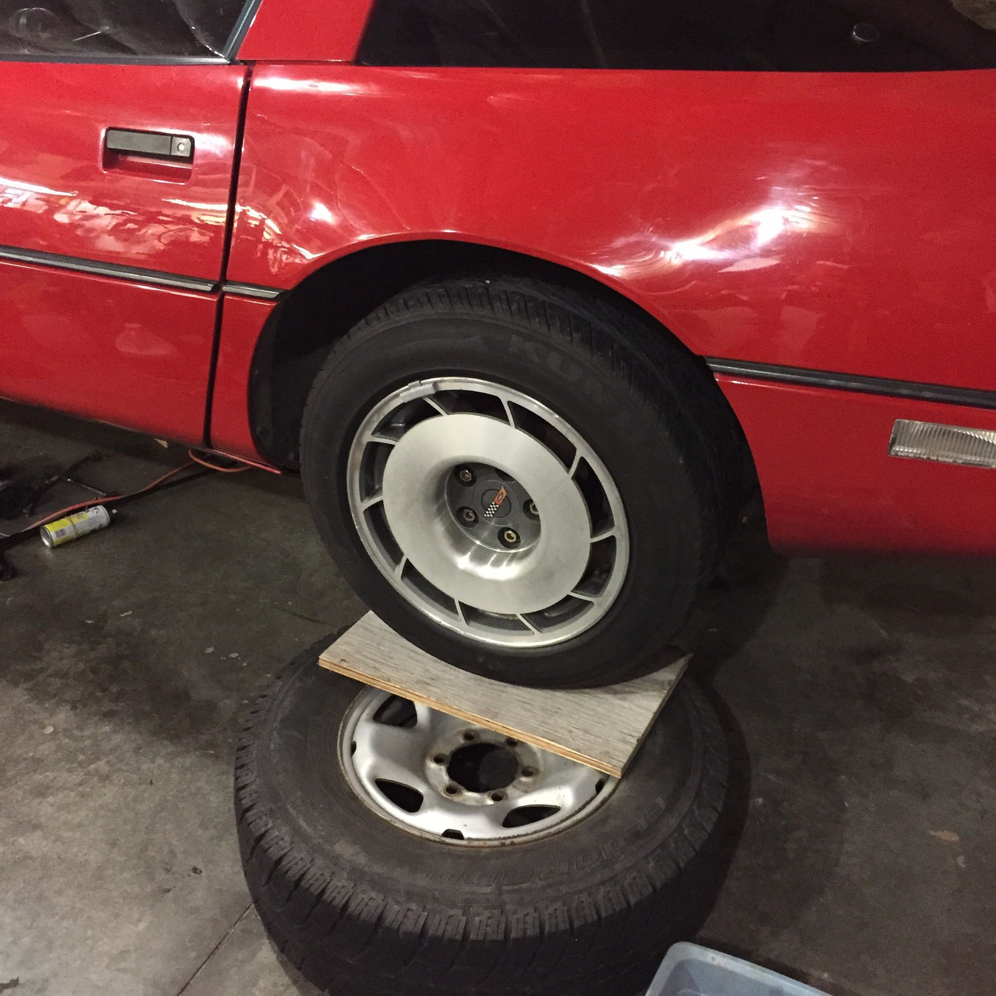

Goals: replace rear pinion seal and tailshaft bushing and seal.
Currently tranny is supported with the car jack from my tacoma.
Issue: i think im fubar because i chose to put old tries/steel rims under the 4 tires as the support method. I need to rotate the drive shaft with tranny in neutral to get at the 8mm bolts on the opposite side of the spicer u joint.
I cannot jack up the back end in the current condition because the tranny will drop.
Am i putting the c beam back on here folks? re install c beam, raise back end using traditional stands on the frame so rear wheels can spin?
Anybody see another way out of it?
its jacked like this:
dont jack like this if you need to remove driveshaft. :-/
